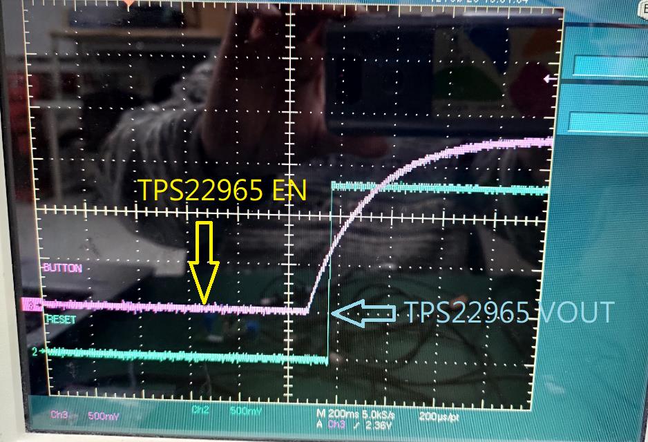

Hi Sir,
We uses TPS22965 EMV to measure, VIN=1.8V,Yellow: EN PIN, we have RC for delay,R:9.3K/C:22uF,
BLUE: VOUT PIN, Vout from 0V to 1.8V only 3mS delay, How we can have delay = 10mS?
Delay time cannot be extend no matter have extra 22uF behind Vout or change RC value in EN PIN.
Would you pls kindly help how we can extend delay time to 10mS? Thanks.
