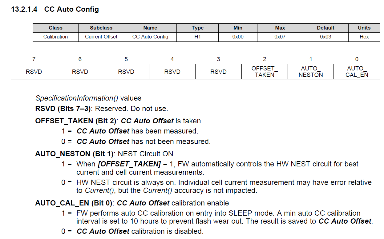

What is the meaning of 'CC Auto Config'? How to configure it?
