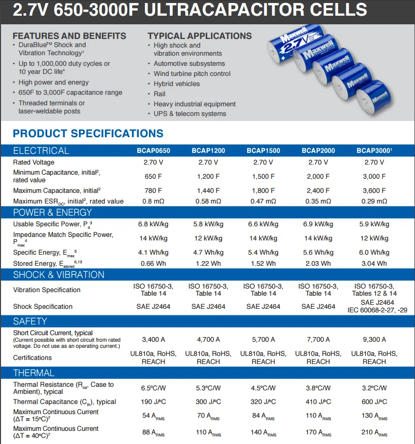

  • 1) Sure, this is my datasheet for supercap
    Super High capacitor 2.7V 3000F Farad capacitor 2.7V3000F supercapacitor
    Packaging  Bulk /Retail
    Part Status Active
    Capacitance 3000F
    Tolerance -
    Voltage - Rated 2.7V
    ESR (Equivalent Series Resistance) 0.29mOhm
    Lifetime @ Temp. 1500 Hrs @ 65°C
    Termination Same as photos Terminals
    Mounting Type Chassis, Stud Mount
    Package / Case Axial, Can - same as photo Terminals
    Lead Spacing -
    Size / Dimension 2.390" Dia (60.70mm)
    Height - Seated (Max) 5.445" (138.30mm)
    Operating Temperature -40°C ~ 65°C

  • Gijoo,
    1) The max value the gauge can support is 655F.
    2) The max communication speed is 100khz
