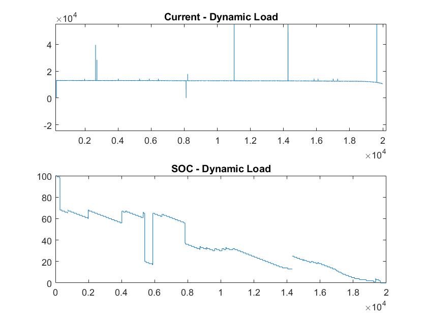

I'm trying to use the BQ34Z100-G1 to supervise a battery of LiFEPo4 -12.8V and 9AH. The load that has to manage this battery is dynamic, for example, a current pulse of 3A, then 0.6A for five minutes and finally 1A for 2 hours. I did the test to identify the chemistry of the battery and then the learning
I followed the recommendations mentioned here http://www.ti.com/lit/an/slua948/slua948.pdf for dynamic loads. Selecting the Load mode = 0 (Constant current) and Load Select = 3 (Low pass filtered average load). In resume, this is the configuration that I'm using:
registers_values_Rev.2.gg.csv

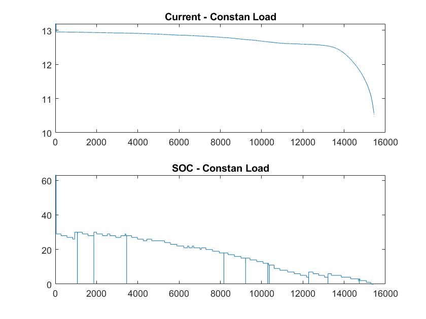

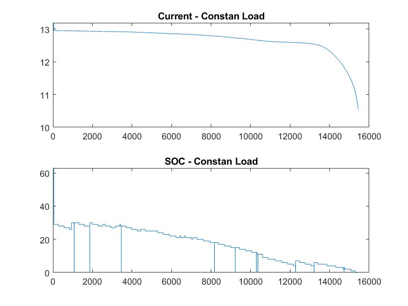

To test the behavior of the gauge I carried out two tests, the first one with constant load and the second one emulating the load of my final product. Getting the following results:
(Ignore the spikes in the charts, That's a measurement problem)
The jumps up in the estimation of the SoC shouldn't happen if I active the SMOOTH mode in the gauge. Here's my problem, why does the SoC deviate so much? The error of this device is supposed to be small. Exist another configuration that I have to do to improve the prediction of the gauge when I'm using dynamic load?
I would very much appreciate help in optimizing the operation of this device for dynamic load.
Thanks a lot,
Andres Suarez
  • Hi Andres,
    Could you provide bqStudio logs files for your two tests?  I would like to check the SOC accuracy.
    Andy

  • Hi Andres,
    I just took a look at this file "ConstantLoad.csv". I the SoC begins with 63%.
    Do you have the entire log file in which discharge starts after the battery is fully charged and rests for over 2 hours?
    Andy

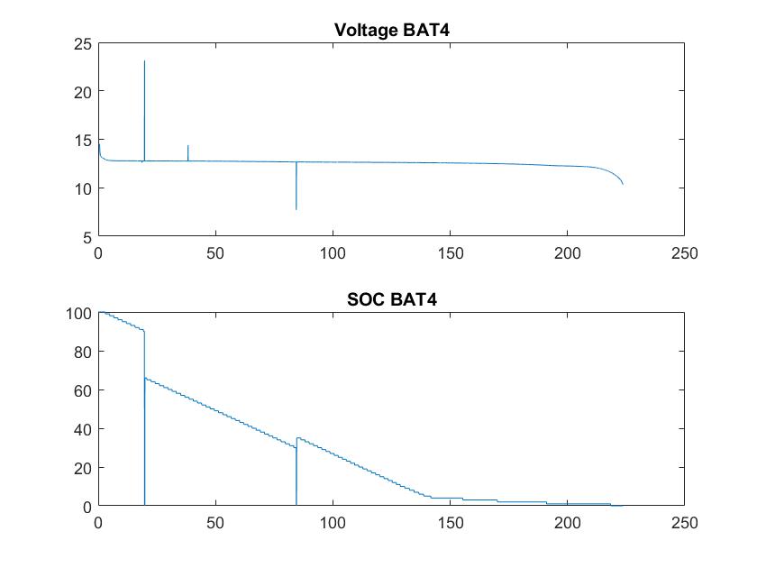

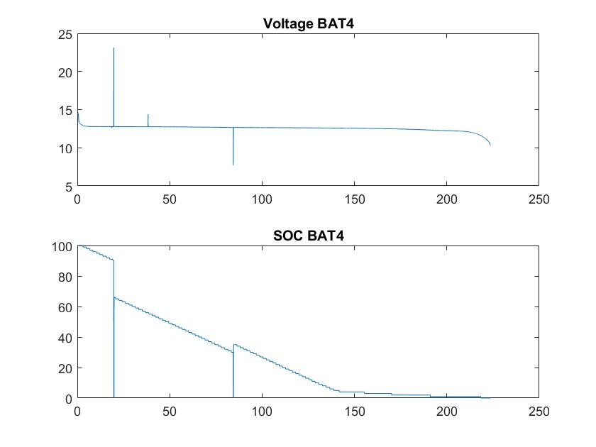

  • Here is another test with those conditions DCH_BAT4_1.txt

    This is the gg file used to run the tests mentioned before: registers_values_Ext_Rev.1.gg.csv
  • Hi, Andres
        According to your previous post, you have enabled smoothing function, right?
        Have checked the reset counter before and after these SOC jumps, as I also see communication error occurred around these SOC jumping points, could this caused by reset?
        If you have not enabled smoothing function, please try enable it
    Yes, I enabled the smoothing function. This SOC behavior it shouldn't be like this if the smoothing function is activated.
    Regarding the reset counter, can you explain with more detail how to get the value of that counter? Because I can not find anything like a reset counter in the BQ34Z100-G1 datasheet.
    Thanks for the help,
    AS
  • Andres
        The reset counter is private, need to check srec file to find this value before and after SOC jump.
        You can also monitor the voltage at VREGIN pin see if the voltage sudden drop when dynamic load is applied.
  • Steven,
    How I can check the srec file? uploading the firmware into the Gauge again? there is no way to check the reset counter with a command?
  • Andres
        The reset counter is contained somewhere in the srec file, you can find its location by doing this:
        1: Export the srec file first, and save it
        2: Then restore the device to normal mode and export the srec file again.
        These srec files are basically text file, you can compare these 2 files with some comparing tools like beyond compare, if you find one byte incremented by 1, then that should be the location of reset counter.
