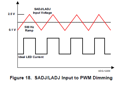

As for the use of ladj, the PWM signal needs to be filtered by RC and shaped into a triangular wave input as shown in the figure below, right? Instead of directly inputting PWM signal.
  • Hi Ping,
    No, the picture shows what happened when an analog input voltage placed on SADJ / LADJ pins.
    Once an analog voltage between 0.1 V and 2.5 V is there, it will be compared against an internal 500 Hz triangular voltage.
    Then the signal will become a 500 Hz PWM signal with corresponding duty cycle, e.g. 1 V turns into a 500 Hz 40% duty cycle PWM signal internally and PWM dim the corresponding LED string.
  • Whether I can input DC signal or PWM signal to control LED current at ladj pin ? It is indicated on datasheet as analog or PWM signal.
  • Hi Ping,
    You can do either DC signal or PWM signal.
    If you do DC signal, please make sure the voltage level is between 0.1 V to 2.5 V.
    If you do PWM signal, please make sure the "0" voltage is < 0.1 V and "1" voltage is > 2.7 V.
