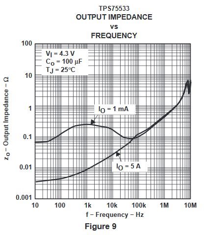

For my application I need to understand the impedance as seen at the output of the LDO.
Thank you,
HSG
  • Hello high speed guy,
    The output impedance of the LDO is provided for these devices in the datasheet, and is a function of load and frequency.
    Please see the following plot from the datasheet.
    - Stephen
