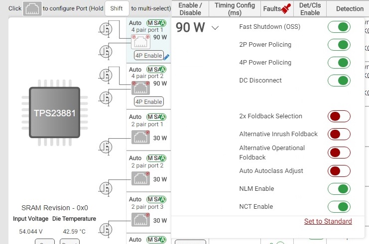

Dears,
I'd like to know what are these functions for? Especially the functions of lower part due to most of them are not defined in 802.3bt spec except autoclass.
I wonder if there is a user manual for these GUI tool, thank you.
  • Hi Steven,
    TPS23881EVM user's guide has the instructions of how to use the GUI. If you want to understand details about port configuration, it is better to read register description in TPS23881 datasheet.
    OSS:15h
    2P PCUT: 1Eh ~ 21h
    4P PCUT:2Ah~2Bh
    DC disconnect:13h
    2X foldback:40h
    Alternative foldback:55h
    Auto Autoclass Adjustment:50h
    NLM/NCT:2Dh
