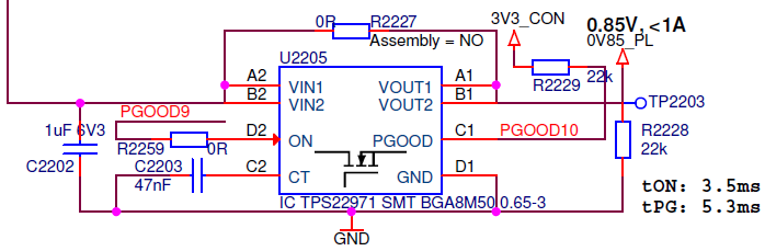

Dear Forum
I have a whole cascade of high side switches in my design and am somewhat stuck with the PG output of TPS22971
Now, I have the following situation VIN1/2 = 0V (i.e. the input voltage is not yet enabled), ON (PGOOD9) = 0V (i.e. disabled), VOUT1/2 (0V85_PL) = 0V (measured, as expected).
I observe that PG(OOD) ramps up with 3V3_CON in this situation.
Since i found no hint in the datasheet for this situation please advise.
