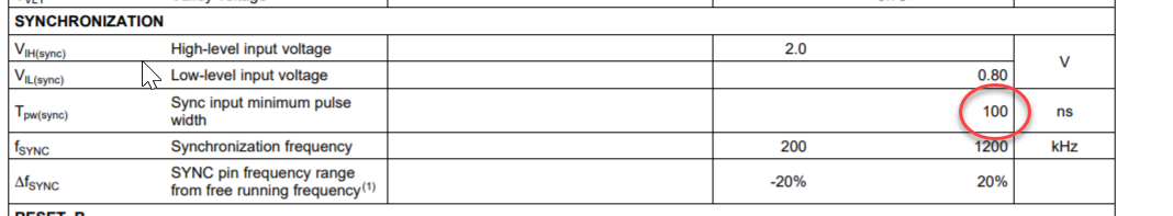

Does the TPS544C25 synchronize to an edge on the SYNC pin? Does the TPS544C25 have a phase-locked loop? Does the duty cycle of the SYNC signal affect the switching duty cycle of the TPS544C25?

Hi Christopher,
The device does not have a PLL.
Also, the duty cycle of the SYNC signal does not affect the switching duty cycle. The SYNC signal needs to meet the minimum pulse width mentioned in my previous post.
