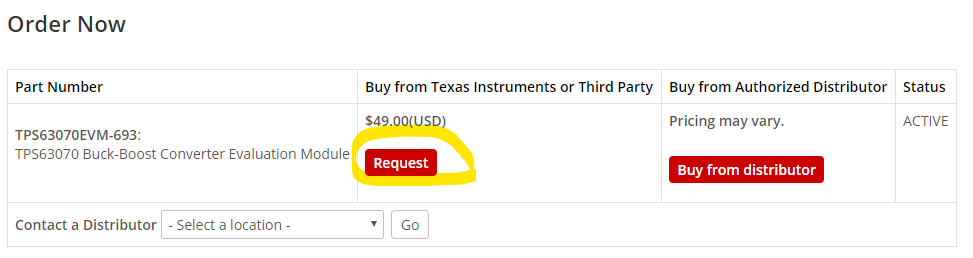

I have two question about TPS63070EVM-693.
1. Is this EVM available on TI store?
I can't confirm the status from the button as below;
2. What is the difference between TPS63070EVM-693 and TPS630702EVM?

  • Hello Ryo,
    The difference between TPS63070 and TPS630702:
    TPS63070: no output discharge during shutdown
    TPS630702: output discharge during shutdown
    If the customer does not care about the output discharge feature, recommend the TPS630702EVM.
    If the customer wants to keep the output voltage available when EN or VIN is removed, he should request the TPS63070EVM-693.
