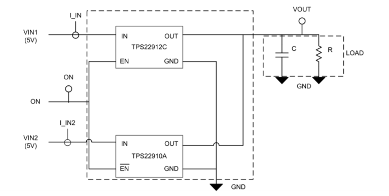

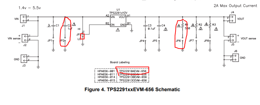

Received a 2nd EVM board TPS22910AEVM-656. Stuffed JP2 (C2), JP6 (R1 560OHM) and JP3 is set to LO (enabling the load switch); Vin = 5V. Measuring Vout, there are no voltage.

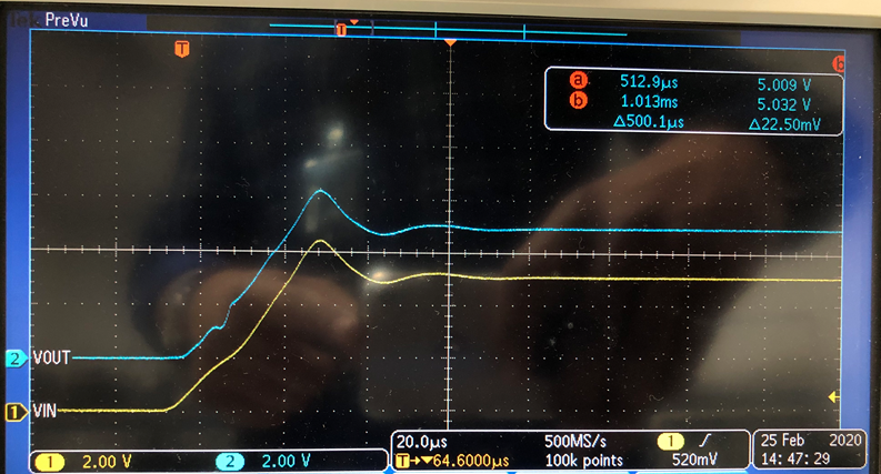

Set Vin = 3.3V, Vout = 3.296V

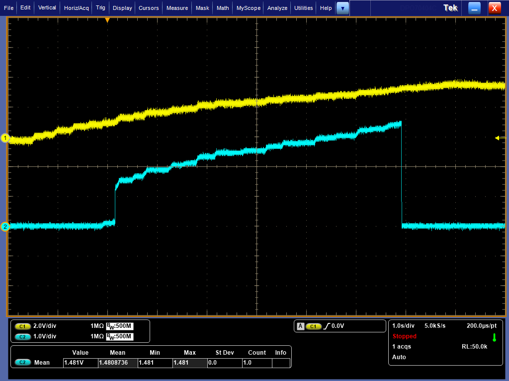

Here is a manual sweep from Vin CH1 (source from power supply), and Vout CH2. Is there a different part number for TPS22910A to operate at 5V?
