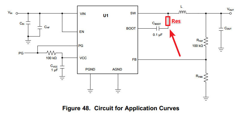

I am helping customer to review LMR33630-Q1 PCB Layout. I have onequestion need to ask.
Does it need to add another res serial with Cboot?
I saw datasheet doesn't have such a res. Just want to confirm whether need to add or not.

The Rboot is used to slow down the rate of switching edge. It brings a better EMI performance but makes efficiency worse. So normally we don't need it, however if your customer has strict EMI requirements then you can suggest them add a Rboot pad for debug.
