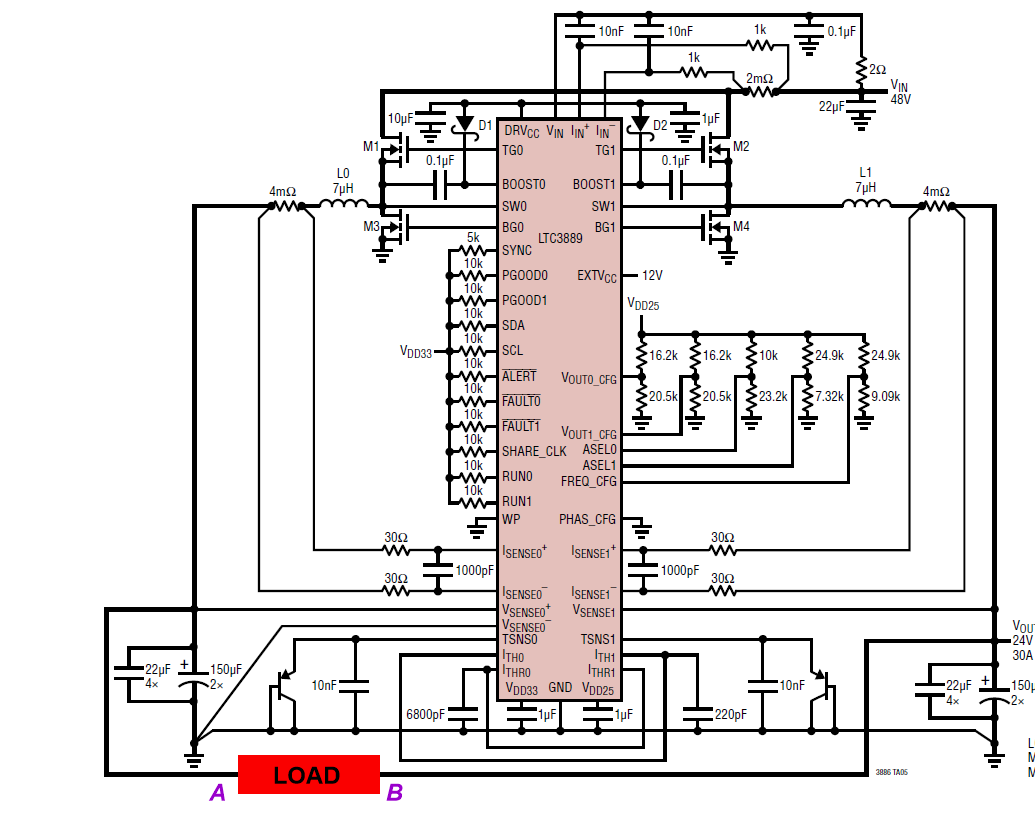

APPLICATION:
Build a power supply to individually power four Thermoelectric Peltier Cooler modules where the voltage to each of the 4 TECs can be separately controlled by the host on PMBus.  Additionally, I need the V and I of each output reported back to the host.  Ripple on output is not critical (even 5% is acceptable).
Vout Range = 0 to 14V (say from PWM duty near-0% to near-100%)
Iout (max) = 10A (each)
Vin = 16V (can arrange a higher V here if needed)
Ideally, the PWM going to the MOSFETs driving the 4 TECs are phase shifted to minimize ripple and input capacitors.
Also, the TECs will be connected in a full H-bridge configuration to enable reversing the current.
WHAT I FOUND:
CSD95492QVM
     Problem - Output voltage, Vout max is 5.5V
     It appears this would have worked with TPS3679
Thank you much!
