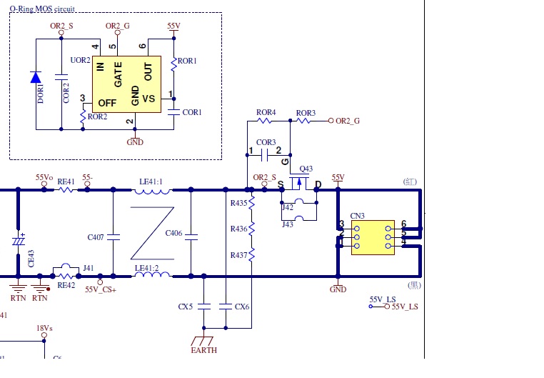

Hi Sir,
when performing a surge, common mode test, i found that the LM5050 Gate will drop and cause the output voltage to power down.
as confirmed that as long as the IC GND is connected to the primary side GND or the ground through a Y or X capacitor, this phenomenon will happen, have any idea or suggestion solution.
CH1: 55V output voltage
CH2: LM5050 pin5-pin4 voltage
