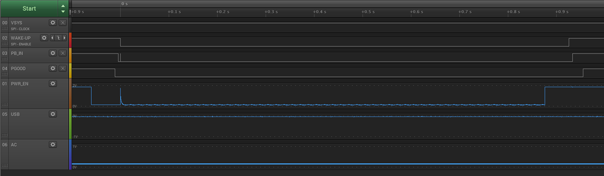

Here is my log.
Please let me know what to check else.
I cannot understand why PWR_EN signal rised up after turn off.

* signal of the lines on TPS65217C

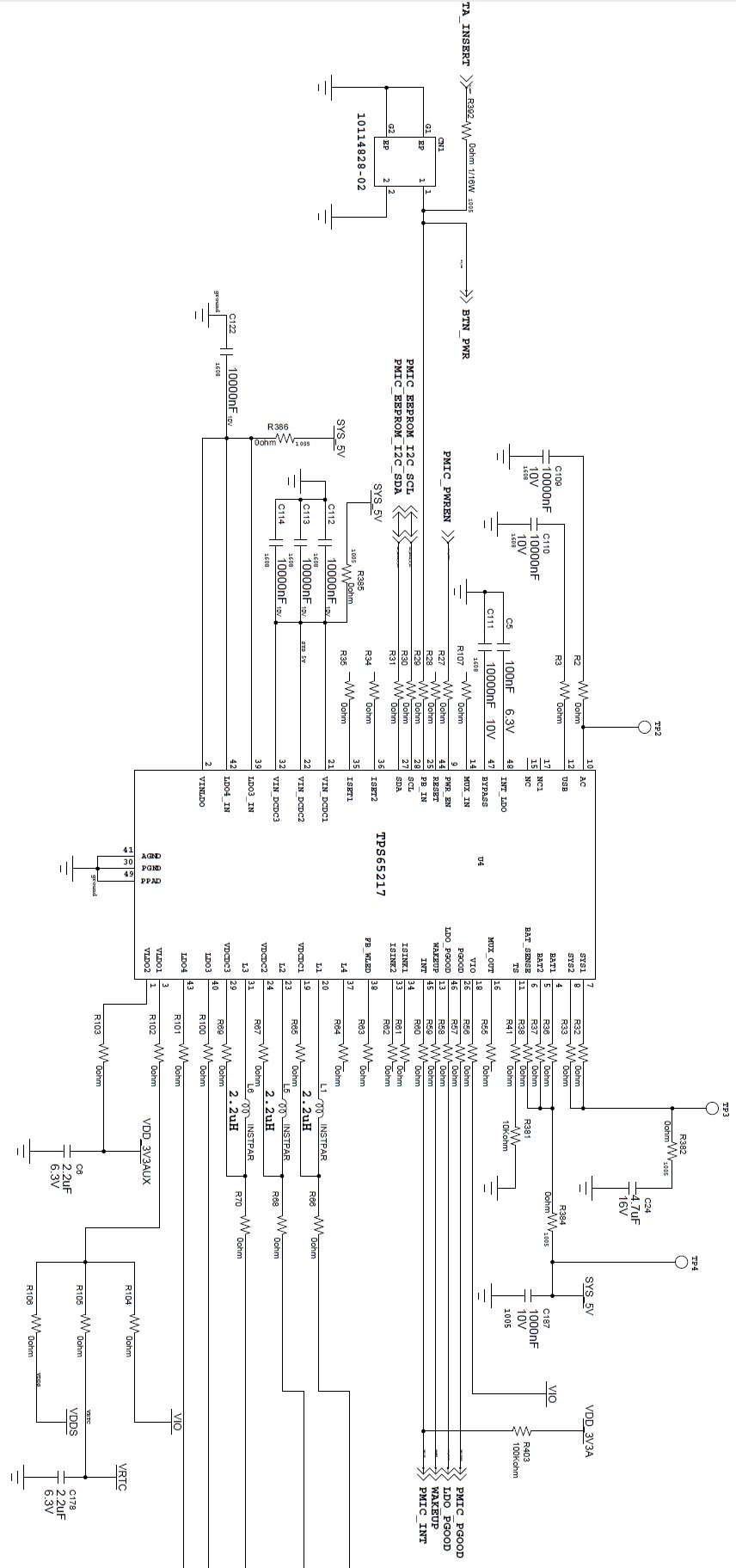

    So, I attached the part of PMIC on my schematics
    "Try shorting BAT_SENSE to BAT1 and BAT2 pins, then pull all three pins to GND with a 10kOhm resistor."
    Not work on my board.

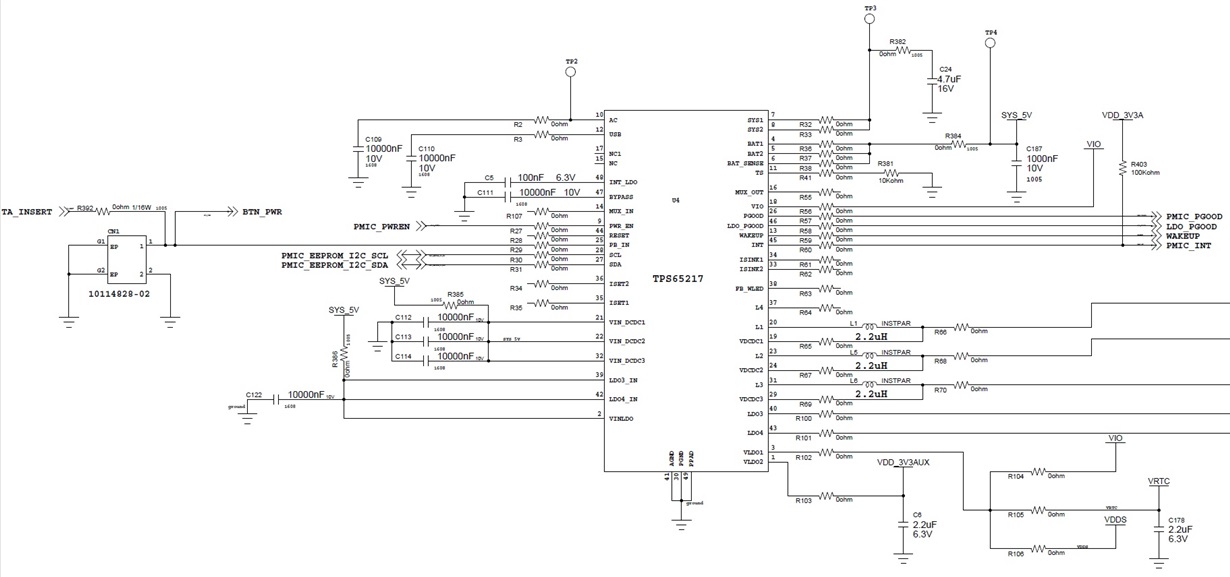

    The below is my schematic

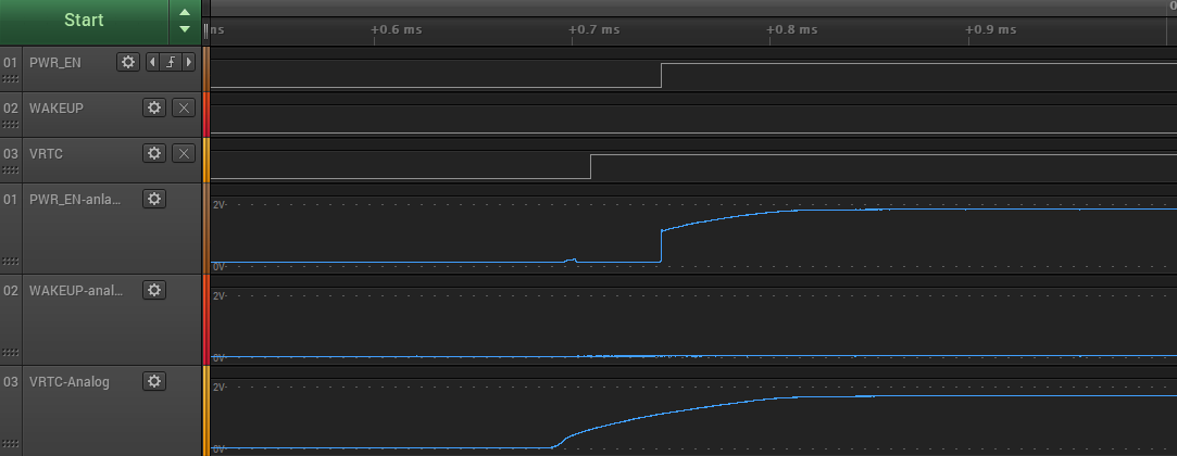

  • I attached addtionaly log.
    At the reboot timing, VRTC enabled first
    Please refer the below log
  • You said:
    Hanjun Kim said:
    I need to use battery default and charger too.
    You need to use battery but you do not have a battery installed. You have a large capacitor installed.
    When you try to reboot and it fails, try pressing the Push-Button (CN1 in your schematic) connected to PB_IN and let me know if the system recovers.
  • After further review of your schematic, I see you are using BAT as the main input to the system. Instead of a battery, you connected SYS_5V net directly to BAT inputs.
    This circuit should work fine, but you might need a push-button press to re-boot as expected.
    Also, when you wire circuit this way (BAT = SYS_5V), AC and USB un-used, the recommendation is to short AC and USB directly to GND.
    Please remove C109 and C110 in your schematic and replace with short to GND. This should also improve re-boot performance.

  • Please check PWR_EN signal.
    Also make sure OFF_BIT == 1b in TPS65217 Register Map. You can check my "sniffing" I2C communication before PWR_EN goes low.
    Refer to Figure 24. Global State Diagram, on page 39 of the TPS65217 datasheet to make sure you are entering OFF state correctly and no events occur that make system leave OFF state back to ACTIVE state.
