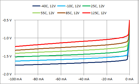

The absolute maximum output current of NE555
Other Parts Discussed in Thread: NE555
The absolute maximum output current of NE555 is discussed in the datasheet.
What is the absolute maximum output current? Which one may by occurred? NE555 may be damage if it operates over its' absolute maximum output current 225mA or the output current can be clamped to its' absolute maximum output current 225mA.
If the capacitor is assumed as the NE555's load, what the current waveform can be observed? High pulse current or the current is clamped to its' absolute maximum output current 225mA?
