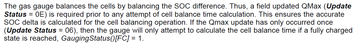

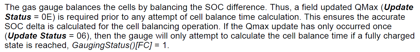

Customer is using the BQ40Z50 in a 2S application. They run the learning cycle and Update Status goes to 0x06, all is good. Our app note SLUA903 indicates that the first field update will change Update Status to 0x0E and cell balancing will be enable.
Customer question; Can he run the second update cycle(in place of first field update)  during golden image generation so that cell balancing is enable, rather than waiting for the first field update.
