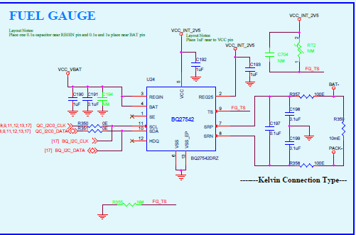

  • Hi Damian,
    Thanks for your reply.
    Yes, we are using on board battery protection circuit,gauge and battery charger.
    here i am attaching the screen shot of the same
     Please let me know you find anything wrong if you found.

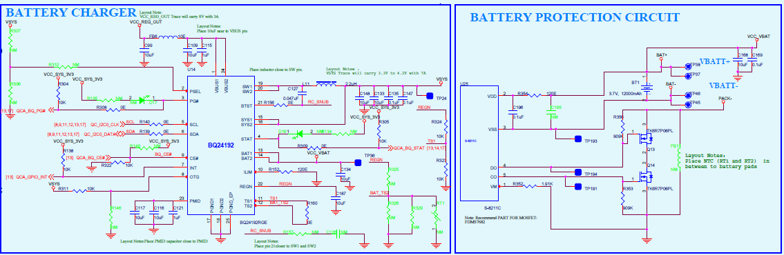

    Already attached screenshot of the following ckt.
    1.Battery charger
    2. fuel gauge
    3.battery protection ckt.

    I believe the issue is your Battery Protection IC S-8211C, charger and Fuel gauge grounds are incorrect. This is the source of the issue. Fuel gauge VSS should be BAT- as well as it's components ground reference. Charger ground connection should be CHG FET source, which it is correct but should be PACK-. SRN should be connected to source of the DSG FET as it currently, but node should be renamed.

    The feedback I provided is what I could help with. Please work with Ning or Battery protection IC support to figure out the issue with charging. The battery gauge doesn't prevent or inhibit charging, it only reports battery conditions it measures. The two ICs with the capability of stopping charging is charger and the battery protection IC. You've mentioned you can charge when the charger is connected directly to the battery, so it looks like the culprit maybe the battery protection IC.  When charging stops or is prevented, have you checked the state of the CO and DO pins? If you bypass the protection FETs (short across them) does charging and gauging function as expected? Please try these debug and let us know, so we can better assist you.
  • Hi Vishal,
    I reviewed your battery protection IC spec and your schematic. I'm very confident that the battery protection IC is what's preventing charging due to the charge overcurrent. The protection IC uses the RDSon of the DSG and CHG FET and the voltage across them to detect charge overcurrent condition. Based on your connections with the gauge you've also included voltage across the gauge 10m-Ohm current sense resistor into battery protection IC charge overcurrent voltage measurement, which is between VSS and VM. In order to resolve this issue the battery protection IC VSS should be connected your PACK-. You also have a bunch of other ground referencing issue on the gauge side, which would impact gauging and gauging accuracy. PLEASE NOTE the gauge IC ground reference should be BAT-.

    When charging stops charging FET is turned off and discharging FET is in ON condition
    Status of DO=voltage across the battery(3.0) (gate of the Discharge FET)
    Staus of CO=0V(gate of the Charge FET)
    If you bypass the protection FETs (short across them) does charging and gauging function as expected?-----Yes charging starts.I have bypassed the FET and tried.

     In order to resolve this issue the battery protection IC VSS should be connected your PACK-.     -------------------------------------
    If i do VSS connect with PACK-, what is the use of sense resistor which is used in between BATT- and PACK-.?
    PLEASE NOTE the gauge IC ground reference should be BAT-.   -------------------------------------------
    yes sure that we have done already
  • The sense resistor between BATT- and PACK- is used by the gauge for coulomb counting and current measurements. It's not needed by the protection circuit.

  • Hi Damian,
    What i did is i have cut the trace which is going between Vbatt- and VSS pin of the protection ic.
    So i have connected Source of the lower (Charge mosfet) which is actual pack- to the VSS.
    in this VM and VSS pins having same ground references. so according to protection IC datasheet charging and discharging action will happen wrt to voltage diff between VM and VSS pin.
    In this case charging was started but it will not protect the battery.
  • In above battaery is charging but not geeting path for discharging .
