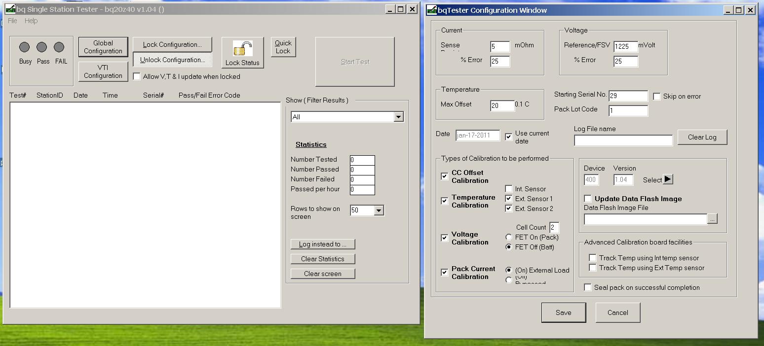

    However when trying to calibrate with BqTester (single site) after passing the test and reconnect to bq evaluation software I read +350 to 500mA without any load or charger. The voltage reads +80-100mV off (true value). When we choose to just calibrate voltage it turns out OK.
    The settings in the global configuration :
    The battery config: 2S2P, 7,4V, 4800mA.
    We followed this setup.
    For the VTI configuration we have 8000mV, temperature: 24, Pack current 2000mA.
    We tried switching pos and neg connection on "Power Supply 1" and changed pack current to -2000mA. After this voltage reading turns out to be -40mV off, and current +330mA
    Is BqTester compatible with bq20z40? Has anyone made a good calibration on z40 with BqTester? Is there anything else we can do or try ?

  • Johan,
    I'm sorry I didn't know you were using the single test station. Unfortunately, we no longer support bqTesetr the single test station. It has been replaced with bqMTester (http://focus.ti.com/docs/toolsw/folders/print/bqmtester.html).
    By the look of the global configuration windows, bqTester doesn't support z40 nor z60 devices because these devices require board offset calibration and that is not available in bqTester.
    Jackie
