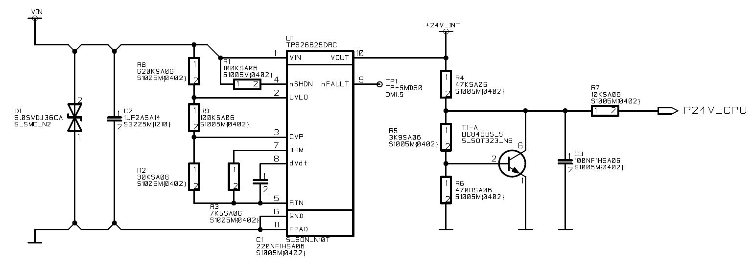

We use following schematic:
R4, R5, R6, T1-A, C3, R7 is application specific.
We start with UVLO appr. 9,8V and OVP 30V; I_OUT > 0,8A; dVdT appr. 100ms.
With calculation sheet "TPS26625 - Design Calculator Rev1p0.xlsm" we get R8(R1)=620kR(619,6kR); R9(R2)=100kR(98,6kR); R2(R3)=30kR(30kR).
1st problem: The calculation sheet does not consider the max. voltage of 3,5V (for low leakage current) at the UVLO pin, therefore we use now 680kR; 62kR and 30kR (for the first step okay).
2nd problem: We have shortet EPAD with GND and not EPAD and RTN-Pin, but we have no return voltage, therefore no problem.
3rd problem: UVLO is working, but we have no OVP shutdown and we cannot see the source of this failure (tested without D1 ;-). Please help.

  • Hello Peter
    Your findings about calculation sheet are correct. The current revision of calculation sheet does not incorporate for max UVLO voltage. We will update this sheet to flag when device ROC is violated.
    On OVP cut off issue I would like to know following
    1. Please monitor OVP voltage. Please share a scope shot showing VIN, VOUT, FLT and OVP pin.
    2. I would like to check if you are not using any other variant of TPS2662. This could be because of the parts wrongly shipped to you or different variant used at your end. Please check top side marking of the device.

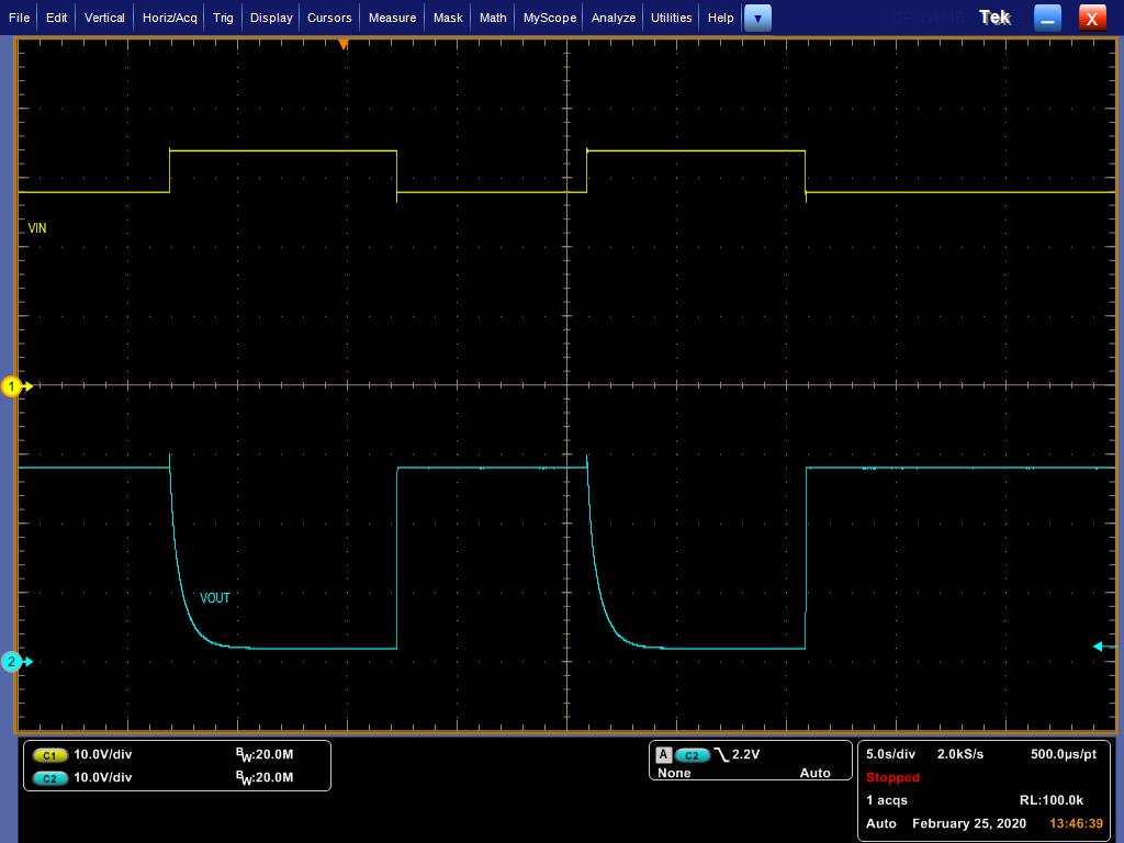

  •  compared EVM device tOVP cut-off response on TPS26625 EVM. Please see below waveform.
    VIN Nominal: 28V
    VIN- OVP SET: 33V
    I do not see any issue with your schematic either. Can you try replacing part with new one. Just to make sure device OVP pin is not damaged or there is no connection issue as such
