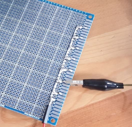

  • Hi Minqiu,
    I don't have the picture of whole environment.
    But following picture is the device I made for the test.
    I made 3V input with my power supply. The current limit was 1A.
    The 3V is provided to the EVM through a multi-meter to measure current.
    The values of chip registers are 660K, 297K, 100K, 60K, 30K, 3K, 300, and 65 ohm.
    The current using BYPASS mode were in uA,
    4.44 10.00 29.81 50.59 99.09 968.70 9897.00 45375.00
    The values were so good.
    The current using Boost mode (after the changing jumper in EVM) were
    12.70 20.02 46.04 73.45 137.83 1385.70 13215.00 64260.00

  • Hi Minqiu,
    I know I also think that was quite strange.
    I just wondered I made some mistake. So, I did that again just before.
    Here is my env.
    I'm using Fluke multi meter to measure the current, and ITECH power supply.
    Before starting, I measured the resister value. It was 62.5ohm.
    Here is the results.
    Vout was 3.352V and current was 66.21mA.
    Vin is dropped to 2.851V.
    Can you tell me where my problem was?

  • Hi Minqiu,
    I guess temperature is not the issue.
    I connected like the following order.
    (1) Power supply -> (2) current meter --> (3) (Vin) 61291 EVM (Vout) --> (4) Load(registers).
    66mA means the displayed value in (2).
    I measured Vin, Vout, current at the same time (at least within 3 seconds).
    For me, efficiency is comparison of current consumption of two circuits, one is with booster the other is without that at the point of (2).
    The thing, I don't understand neither is that (3)Vout is 3.352.
    Then, when I add the load of 62,5 ohm, in some place, some load is added in parallel.
    I can not find where. Is there any possibility that some parallel register is added in EVM?
    Can you make the same condition in TI?
    Taerim

  • Hi Minqiu,
    I really thank you for your response on this site and email.
    Today, I reviewed all my experiments and I found one big mistake.
    I wanted to use similar power while boosting voltage.
    But, the load was fixed. That means higher voltage and higher current were derived by the booster.
    If I compare the systems with and without the booster, the system with the booster uses more power
    because I boosted up the voltage.
    For the booster, in my exp. the efficiency was 94% it was excellent.
    Vin and Iin were 3V and 64.26mA, respectively. Vout and R were 3.352V and 62 ohm.
    As a result, the efficiency was 181.22/192.78=94%.
    I'm not sure my real system consumes the same current on different input voltage, yet.
    Currently, I have to boost up system voltage to 3.3V for wireless communication.
    I hope my system finish work quickly or reduce current consumption
    when it compared with the system without booster.
    Otherwise, now I understand I have the accept increased power consumption to provide
    the higher voltage.
    Thank you, again.
