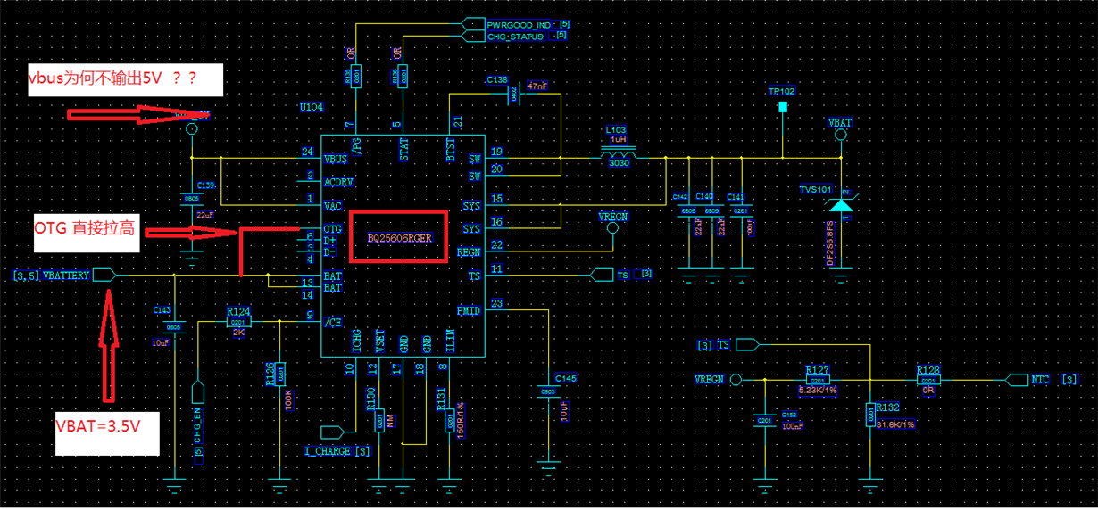

Hi
Now why doesn't VBUS output 5V voltage?Are there any other Settings you haven't noticed? Please give me some Suggestions.thank you

Hi Chen,
BQ25606 enters boost mode and can provide up to 1.2A after startup if
1.BAT above VOTG_BAT
2. VBUS less than BAT+VSLEEP (in sleep mode)
3. Boost mode operation is enabled (OTG pin HIGH)
4. Voltage at TS (thermistor) pin as a percentage of VREGN is within acceptable range (VBHOT < VTS < VBCOLD)
5. After 30-ms delay from boost mode enable
Is there voltage still applied at VBUS? Is there a heavy load at VBUS?
Jeff
Hi Jim,
After re-reviewing the schematic, I only see 100nF capacitor on REGN. The minimum recommended capacitance for REGN is 4.7uF. If not installed, can you install and retry?
Jeff
