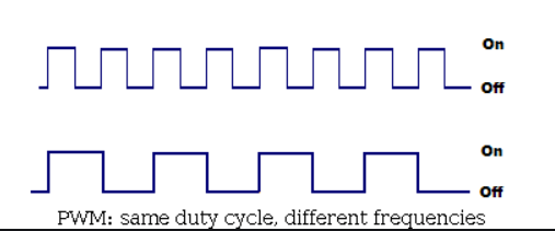

  • Hi Andy,
    In your explanation, the time of on duty is specified by customer.
    When the frequency is very low (i.e 1kHz), the on time of 100% duty is 1msec.
    If customer configure at 50% duty, on time is 500 usec.
    But when the frequency is configured high (i.e 1MHz), the on time of 100% duty is 1 usec.
    In your explanation, if customer configured low frequency, ULN2003 could drive larger current.
    Is my understanding correct ?
    Please let me double check on your answer.
    Thank you and best regards,
    Michiaki
  • Hi Michiaki,
    The frequency only changes the period, or cycle time of the signal. For example, with a frequency of 1kHz each period will be 1ms. A frequency of 1MHz will have a period of 1us and so forth. The duty cycle dictates the percentage of time within that period that the part will be on and off. This means that no matter the frequency, 1kHz or 1MHz, 100% duty cycle still means the device is always on. 50% duty cycle means that the in each period the device will be on on for half of the period and off for the other half of the period. If you average the time that the part was on and off over a minute for example, you will still get that the device was on for 50% of the time and off for the other 50%.
    To answer your question, the frequency does not affect the amount of current you can drive, but the duty cycle does. You can drive larger currents by keeping the duty cycle low. You can observe how the duty cycle affects the current in Figures 4 & 5 of the datasheet.
