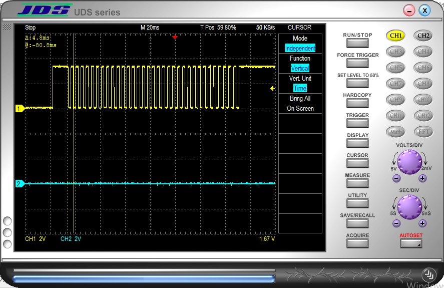

ON S1=CTRL_EN, when CTRL is ON (1-2pin short on JP3), we can observe 4.6V on Vpos and -4.0V on Vneg.
After changing S1=PROG, we input the following yellow waveform on pin10 of J1.
We assumed output -2.2V on Vneg. However we seem no output on Vpos and Vneg.   Please let me know how to operate correctly.
