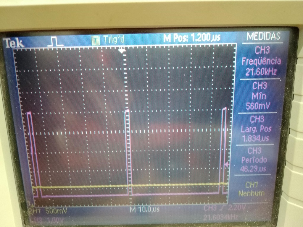

  • UPDATED:
    Hello
    I'm using the configuration bellow :
    The ideia is to feed a control signal, on pin 16, between 0.7 and 3.7V to vary the Duty Cycle between the minimum ( 0% ) and the max.
    I'm having two issues with it that i cannot understand:
    - The PWM Frequency is 21.6kHz, when, according to the datasheet formula, it should be around 16kHz
    - Is there any way i can vary the Duty cycle from 0 to 100% ? the minimum DC is around 3%.
    - The PWM Seems to have a offset voltage of around 0.6V. Can i make the PWM go rail to rail ?
    bellow is a picture of the minimum pwm with the offset voltage
    Thanks.
    Bruno

  • Hi BD,
    First, apologies for the late reply.
    It looks like number 1 amp is tied low by the inputs, and amplifier 2 is configured as an voltage follower, inverting input connected to its output FB.
    Have you checked to see if the FB pin is following the VCrtlin_1 voltage as it changes?
    Note that the output stage is driven by bipolar transistors so there will be a voltage drop across the transistors when they on, a VCE sat, see page 6, section 7.8, of the datasheet for details.
    The log scales are difficult to read especially if the value does not fall on the crossing point of the major units. If the value falls midway on a log scale then the value is sqrt of 10, 3.16, not 5. Looking at the graph I would have selected a resistor value around 7k for 16kHz.
    Peter
