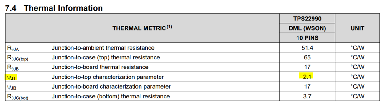

My customer would like to calculate Tj temperature. They measure Tc temperature which is 96.7℃.
Pd=I^2*R=8.7168^2*0.006=0.46W
RθJC(top) =65℃/W
Tj=Tc+(θJC*PD)=96.7+(65*0.46)=126.6℃ > SPEC=125℃
Is there any error in above calculation? It seems like my customer cannot use this chip.
Thank you.
Jim

  • Hi Jim,
    You can use the equation you mentioned to more accurately calculate the junction temperature of your system.
    With your power dissipation = 0.46 W, the value for the junction to top characterization parameter = 2.1 °C/W, and your measured Tc = 96.7 °C  the total Tj = 97.6°C. This is under your desired temperature.
    Usually Tc is a couple degrees above Ta which validates the value they obtained, but how did the customer calculate Tc?
    Andy Robles

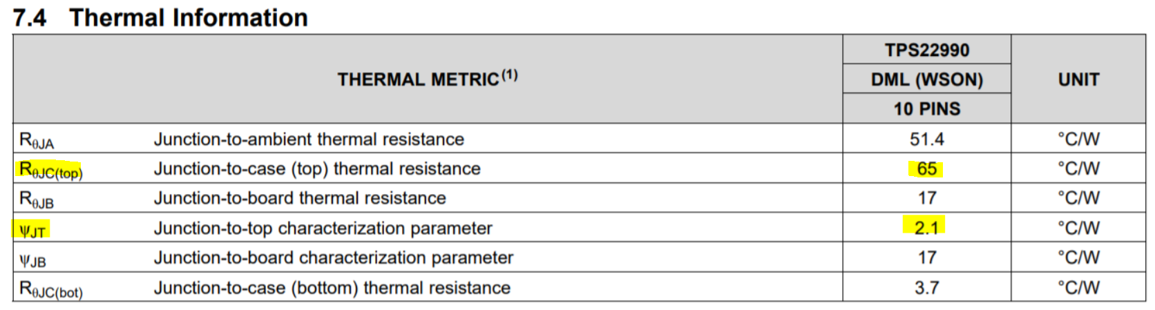

  • Hi Andy,
    They measure the temperature at the case directly to get Tc = 96.7 °C.
    But I feel confused that what is the difference between below two parameters in yellow?
    With 65°C/W, I got Tj= 126.6°C => Failed
    With 2.1°C/W, I got Tj= 97.6°C => Pass
    When should I choose 65°C/W?
    Jim
