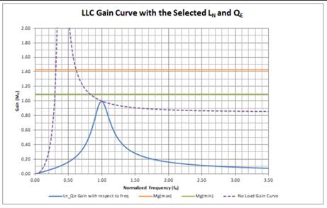

Dear Sir,
I have a problem. It is FET Dead of H/S & L/S when start up that peak current is over 50A.
It is possible below spec to use UCC256303?
can you please advise me any comment for below spec.
1. Topology : LLC
2. Input/output : 70~90VDC / 24V/10.0A
3. Specification
   1) Trans and resonant Tank => Lp&Lr Trans
       - Pri : 20T , Sec : 10T
       - Lp : 220uH
       - Lr : 40uH
       - Cr : 40nF
   2) IC : UCC256303
       - Vcc : external Bias
       - Blk : external Bias
       - Vcr(up) : 47pF/1KV
       - Vcr(low) : 2.2nF
       - Isns(up) : 47pF/1KV
       - Isns(low) : 330R
   3) Primary FET
       - Vds : 200V
       - Id : 27A
       - Id_pulse : 100A

  • Hi Dexter,
    I calculated the gain curve with the power stage parameters you provided. The power stage does not have enough gain to support 24V at 240W.
    The power stage needs to be redesigned to achieve higher gain if your customer would like to stay with LLC topology.
    I also want to mention the design spec (70V-90V input, 24V, 240W output) fits very well with active clamp forward topology. Here is an active clamp forward reference design that is close in input range and output power to your customer's design spec:http://www.ti.com/tool/PMP7376
