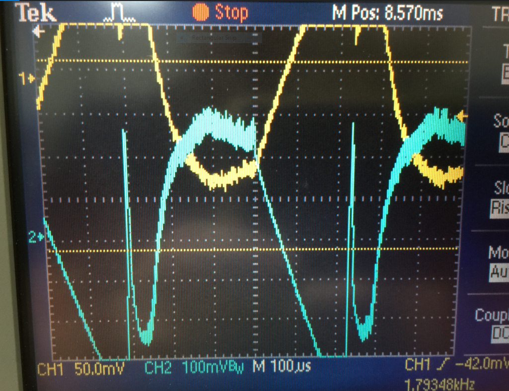

This we Buck is really giving me a hard time. It seems to be oscillating much slower that specified. Changing the pull down resistor does make device run faster(RT) pin 6.
Let us start with basics, this device is configured as per EVAL board. I start my testing with the supply set to 15V DC, and actually with 10R load we ge very little ripple voltage and a lovely 3.3V DC output, one might think that is all dandy and good. However as load changes even to 20R we get lots of LF ripple(2khz) voltage and device is unstable, the output voltage is 3V with over 500mV ripple voltage on top.
Cin =22uF 100V MLCC
Cout=100uF, but it photo changed to 47uF
RT=220k. To me Fb is totally screwed, but would this explain the oscilator operating at 2kHz, i think perhaps we have a faulty part, but given at high loads it works makes me feel that the device is conditionally stable? What are your thoughts?
Yellow=Vin / Blue= Vout.
