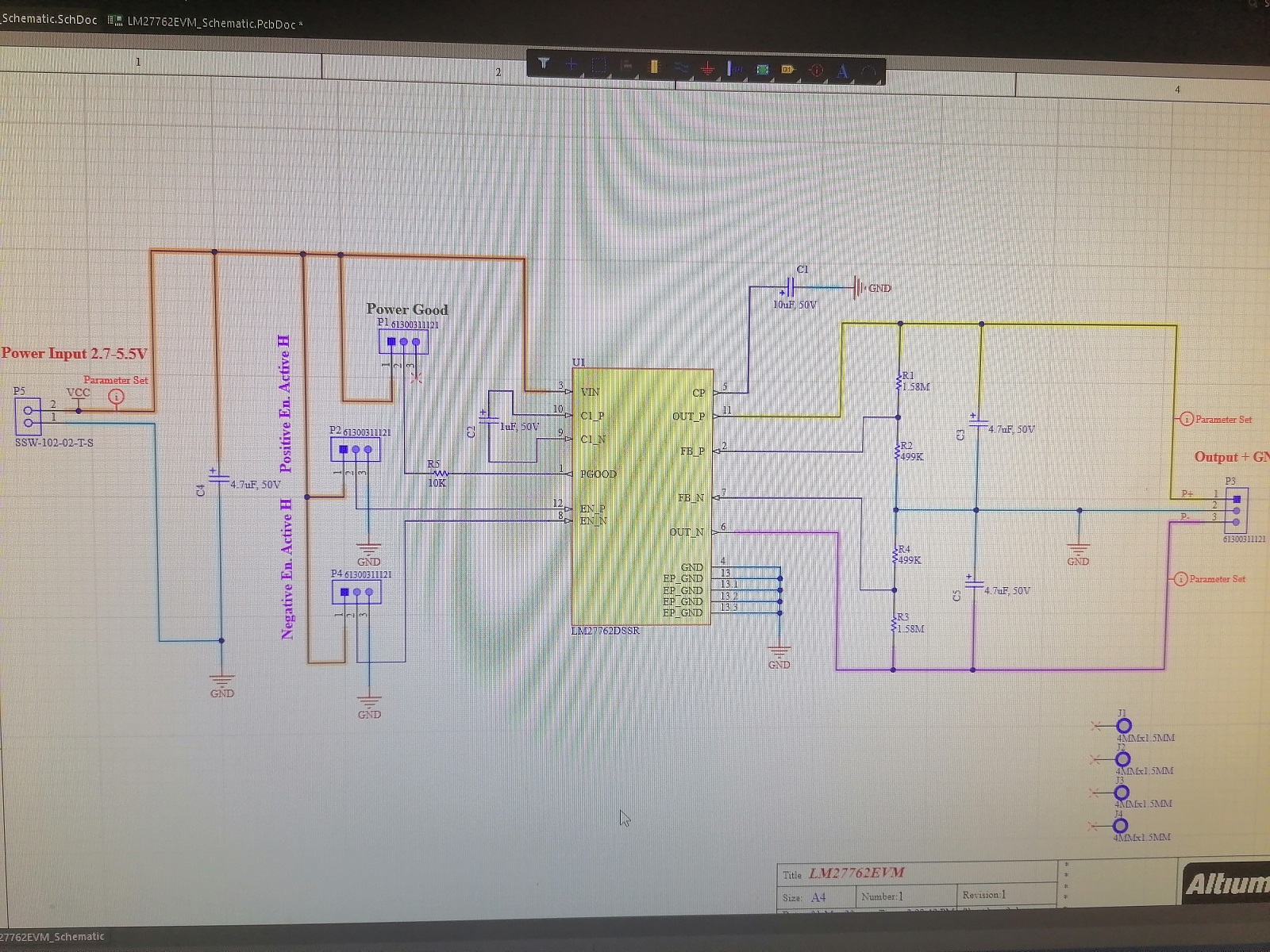

hello everyone,
i was trying to make some testing on LM27762 before i use it in other projects.
so i made a pcb with Altium and designed the schematic based on the values from Texas Instruments site using WEBENCH so the voltage divider were 499K and 1.58M because i wanted to have +5 and - 5 from 5.5 Power..
anyway i made the circuit and tested it and i got from the positive output the same voltage from as input and from the negative output always - 3.8 as Minimum
the value of negative output is more positive like - 3 when i reduce the input voltage and the output of positive output is always the same as input.
now i replaced the chip because i thought it might be damaged or so, but i got the same results.
can someone helps me. Thanks in Advance.
  • Hello Majd,
    Can you please share the schematic diagram and layout so I can check it? If you are not comfortable sharing it here, then I can send an email.
    Thank you.
    Excel
    can you send me a schematic and can you give more info about your application Vin, Vout and the load for the positive and negative rails?
  • Hello thanks for your reply,

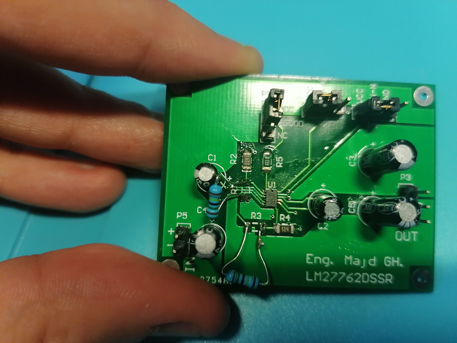

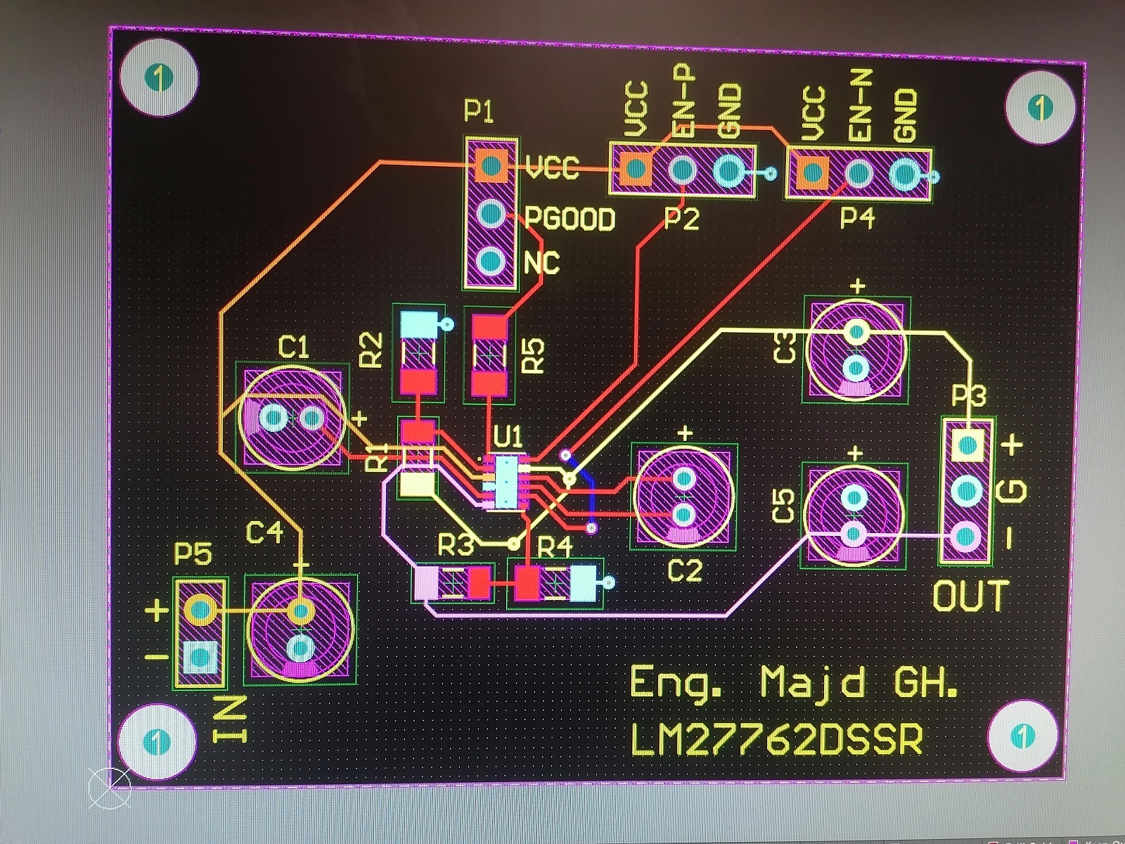

    these are the photos, and as a notice i used 1.5M resistor because i don't have right now 1.58. and this is only a test and when i see that this IC can work with my projekt i planned to change the components to 0805 or and put the caps on the bottom layer.
    I forgot to say that the Enable + and - is working correctly but the problem that described above is still exist.
  • I still didn't use any load on the output.. because i still see a problem with the output.. negative voltage is not correct and positive, negative voltage is not regulated
  • hello
    until now i didn't discover the solution. I checked all tracks an connectivity under microscope but it seems all is correct.. No short and all pins are connected with each other, i bought the 2 Chips from Mouser, could it be that both are damaged?
    because even the positive rail has always exactly the same input voltage.
  • The capacitors must be ceramic. Electrolytic capacitors have too much ESR.
    Please read section 10 of the datasheet; all those guidelines need to be followed.
  • okay thanks for reply. i would re design the circuit and order all Ceramic Capacitors. i also would buy new LM27762 chips to test with the new board.
    but i need jetzt sometime.. i would post the results in the future.
    anyway i didn't take these rules into consideration because that was a quick test and i didn't thought at this too low oscillating frequency that this going to cause this Problem, because i sometime make circuits that works upto 100 MHz on breadboard. Thanks
