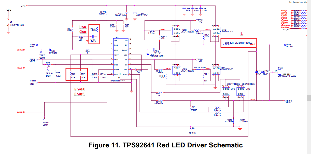

However in the SCH ,the L is only 1uF.
Which one is correct? Could you please tell me how you calculate L=1uH?
