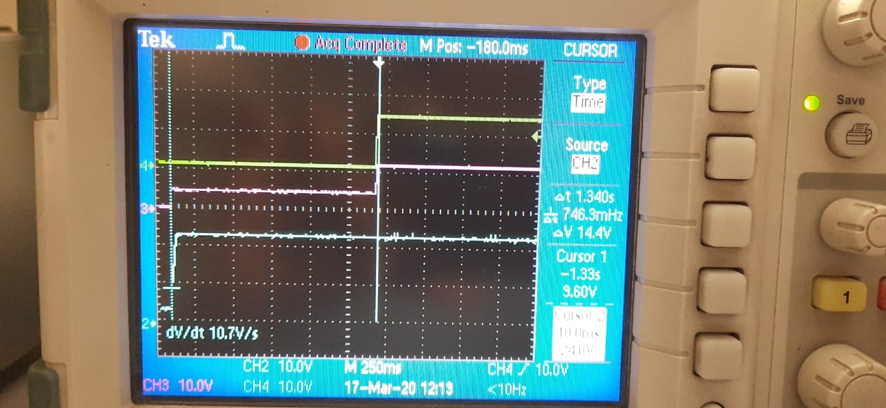

    In our going testing we are facing below issue:
    1) When we start input supply then first 4.5V VCC generated for 2 to 3 seconds and then 7.5V VCC generated,
        due to which output generated after 2 to 3 seconds.
        what is reason for this VCC problem?
    2) If we connect output load initially then DC-DC converter do generate output as VCC is always 4.5V and do not increase to 7.5V,
       and when load decreased then it take 1 to 2 minutes to reach VCC from 4.5V to 7.5V.
    I have gone through Datasheet and application note and do not find anything related this issue.
    Please guide us on this issue.
    Thanks and Regards,
    Mahesh Kohale
  • please find waveforms for  above issue.
    Blue is input, RED is VCC which is 4.5V first and after 2 seconds it rises to 7.5V,  GREEN is output which comes after 2 second.
  • Hi
    when use Vin power up internal LDO, it has limited current capability for driving mosfet. how many mosfet you used?
    we are using single Mosfet as it has limited current capability.
    but as shown in above images, problem is about VCC generation.
    as VCC is initially 4.5V and then increases gradually after 1 to 2 second to 7.5V.
    Please guide on this about VCC.
    Thanks and Regards,
    Mahesh Koahle
  • Hi
    you can remove the mosfet, let the chip work at open loop condition, see VCC has the issue or not.
    in this working conditon, you also can connect chip's SW to GND, so the drive work at no load conditon. VCC will work at early no load condition, so that you can diagnose it is mosfet issue or other issue.
