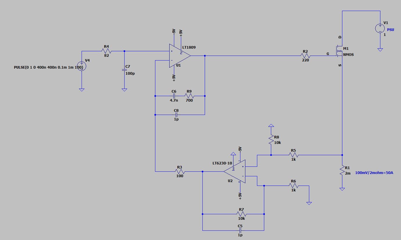

    my circuit below

  • Hi john
    yes, eventually I will parallel the MOSFETs. But my main concern is how much max current can I pull from a single MOSFET practically.
    Practically in the sense with practical Rth(JA). Not like Tcase as 25degC. I am assuming Tcase to be 75 to 100degC
    So please suggest what is the maximum continuous drain current practically I can pull through a single MOSFET(CSD17573Q5B) with VDS as 1V.
    Also could you please suggest a MOSFET with Drain pad exposed on the top side instead of the bottom so that I could have a heatsink attached on MOSFET from the top. So that I can achieve 2degC/w heatsink
    Santosh

    I'm not sure what you mean by VDD. Should this be VDS, drain-source voltage of the FET? There is not a limitation on VDS to get 40A IDS. Please look at Figures 2 & 3 in the datasheet. With the right gate drive, you should easily achieve IDS = 40A at VDS = 0.8V. The typical data shows you will need VGS ~ 2.45 V to get IDS = 40A.

    by VDD I mean see attached image

  • Hi Santosh,
    You are welcome. Thanks again for your interest in TI MOSFETs. I think maybe we're getting too bogged down with the details in the MOSFET datasheet and not focusing on your application. To me, it appears that this circuit is used to test a DC-DC converter with a constant current load. Please let me know if I can provide any more insight or information as to how our FET will perform in this application.
