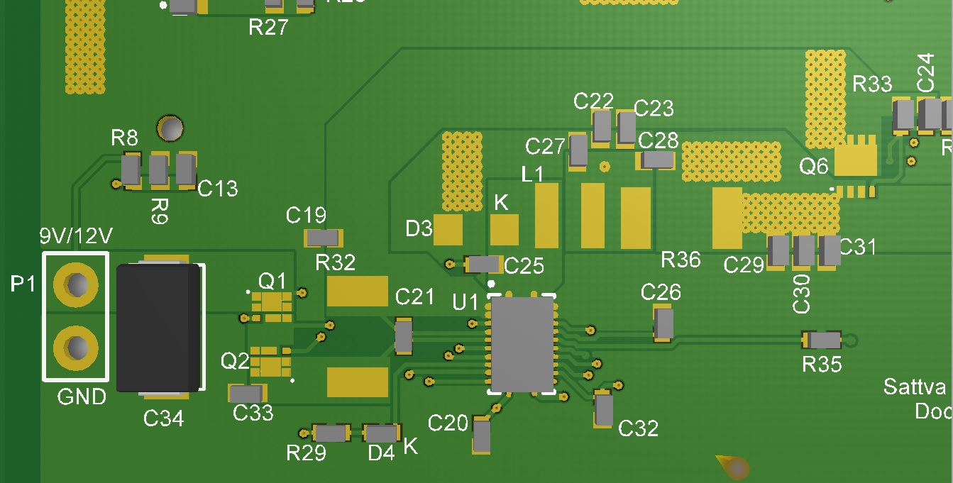

  • Here is what I have and have not followed from the guidelines (page 31/41 of datasheet):
    1. 10uF and 0.1uF (C7, C8 from page 18/20 of the evaluation module design) are NOT close to PVCC pin 2 and 3 of BQ24170. (A distance of about 8 mmm as compared to 2-3 mm in EVM board)
    2. My inductor is quite close to the Switching pins 1 and 24 of BQ24170. I have a 7.5 x 2 mm polygon poured over the switching pins and the switching terminal of the inductor. I am using SRP5030CA-3R3M inductor from Bourns which meets the current requirements of the design.
    3. The charging current sense resistor is very close to the Inductor. However, the sense leads are not routed on the same layer to the BQ24170. The SRN terminal is routed via the the top layer, while the SRP terminal is routed via an inner layer. I did not quite understand the 'do not route the sense leads through a high-current path'. Does this mean that I should not take these traces through the high switching current loop of the BQ24170? In the successful design though, I have routed the traces exactly as done in the EVM.
    4. The output capacitor is right next to the sensing resistor output as well as ground.
    5. I did not understand this. I have polygon poured all 4 layers in my design to PGND. (neither did I do this in my successful design)
    6. Again, I have not done this in either design. But from what I see in the EVM's design on page 14/20, PGND and AGND are connected with a big polygon on an inner layer.
    7. I have done this in both designs.
    8. This has been done as far as possible, but to a slightly lesser extent in the second design.
    9. I have done this in both designs.

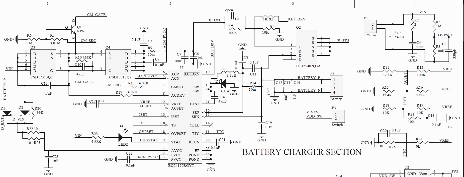

    This is a screenshot of the not working design layout

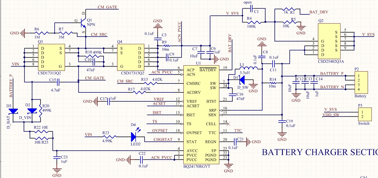

    This is a screenshot of the schematics used in both designs:

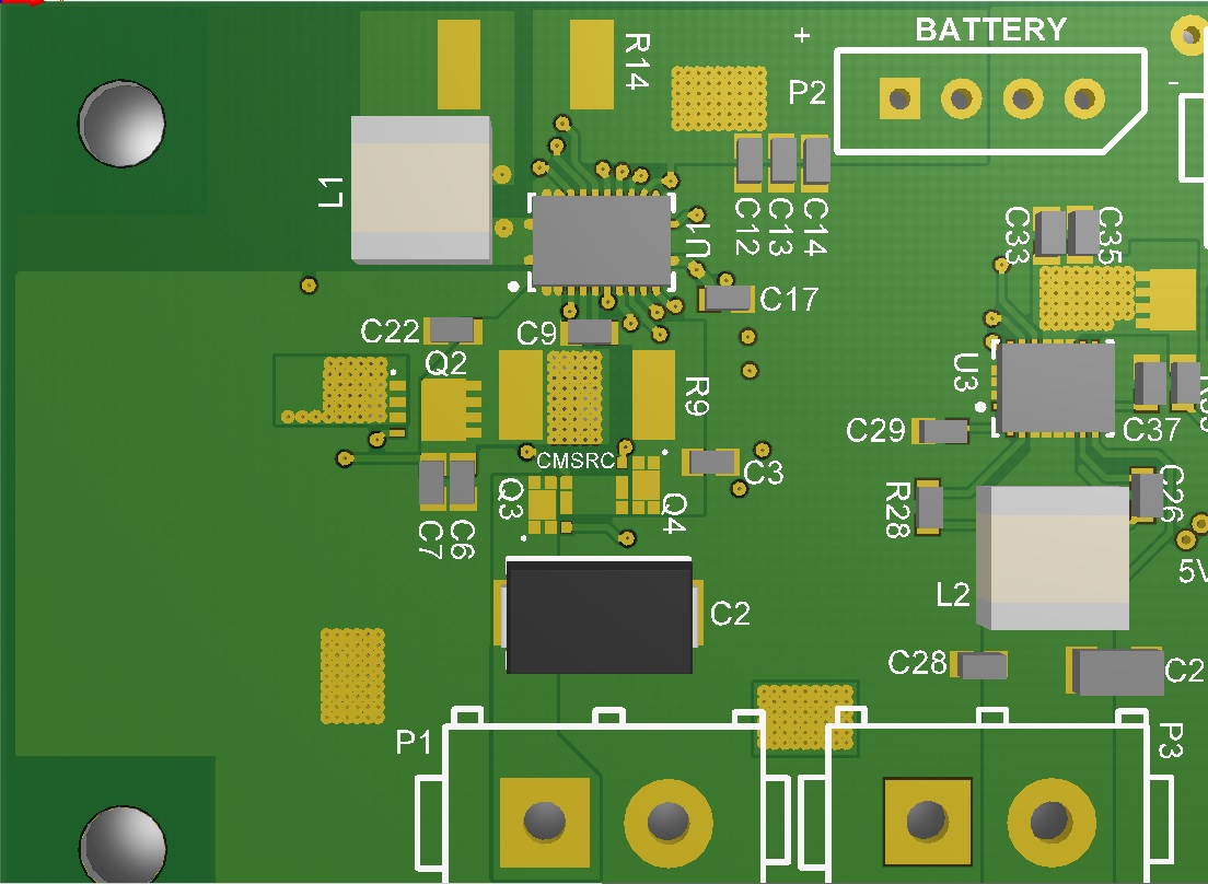

    This is a screenshot of the working design:
    My design is in solidworks PCB which is based on Altium. But the file extensions are different from Altium. If sharing the gerbers will help, then I can do that.

  • Dear Darien,
    As a first check, could you solder a known working IC to the board that is not performing as expected? I just want to eliminate the possibility that the IC is the problem.
    Second, could you please probe the ISET voltage in each case? You do not seem to bias it in your schematic. This pin along with RSR helps to set the charge current. By leaving it floating on two different layouts I suspect that the ISET voltage is different in each layout, causing unexpected results.

  • Dear Michael,
    Thanks for your response. I will solder another working IC from a reel and check and get back to you on this. Since this fault happened uniformly across all 4 assembled boards, I assumed it was a design flaw. But I will solder a working IC and check. Apologies for not posting the whole battery charging circuit. I zoomed into the IC itself and left out all voltage divider setups. Here you go:
