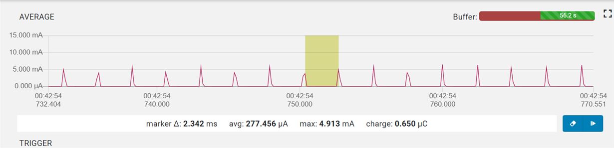

We have placed a 10K Ohm load on the TPS61099 and expect to see an average current pull of 0.12mA, (we are using a 1.2v power source).
We are actually recording a current pull of a maximum of 4.913 mA every 2.4342 milliseconds.
Can you please explain why the current is so high and has a average of 277mA compared with 0.12mA.

    I guess it's caused by the burst mode(PFM). May you measure the SW waveform to double check it?
  • I have attached the waveform that we are seeing as the current pull.
    As you can see from the waveform measured at input to the TPS61099 and load 10K Ohm load on Vout,  we are seeing much larger than expected current pulls. Up to 5-7mA with an average of over 0.277mA.

    The current pulse looks like the Burst mode. If the converter operats in Burst mode, it won't switch continually. There is details in datasheet 8.3.1 as "If the load current is reduced further, the boost converter enters into Burst mode. In Burst mode, the boost converter ramps up the output voltage with several switching cycles. Once the output voltage exceeds a setting threshold, the device stops switching and goes into a sleep status. In sleep status, the device consumes less quiescent current. It resumes switching when the output voltage is below the setting threshold."

    We are measuring the production and development PCBA using a power profiler. To confirm the power profiler accuracy we are connecting with a output voltage of 1.2v across different loads. 100 Ohms, 1,000 Ohms, 10,000 Ohms, 100,000Ohms and 1,000,0000Ohms with the resulting power profiles of 12.5398mA, 1.2285mA, 0.1234mA, 0.0152mA and 0.0036mA respectively.
    When we placed the load of 10,000 Ohms across the Vout of the TPS61099YFF we are measuring the power profile in mA shown in the attached diagram at the Vin of the TPS61099YFF. In other works we are measuring a peak mA of 6-7mA every 2.342ms with an average mA current of 0.227mA at the Vin of the TPS61099YFF.
    We need to understand why the measured input current of the TPS61099YFF can be up to 6-7mA for a 2.342ms with an average of 0.227 mA. The power requirements are much higher than we would expect.

    The Iin_avg=Vo*Io/Vin/Efficiency. And if the load is so light, with Vout =1.8V, it's normal to see Effiency lower than 80%. (So even efficiency=100%, the iin=0.12mA you expected is unavailable to achieve with such conditions.)
    The pulse you observed is caused by Burst mode. It will switch once and wait some time for the next pulse. This behavior reduces the switching loss with light load. If you don't like that, you could add an input filter to decrease the current spike.

    An LC filter or just enlarge the input capacitance could help to decrease the spike.
    The burst mode(PFM mode) is necessary to reduce the switching loss. It's a normal phenomenon for this topology, and not only for TPS61099. And for the efficiency, it's also good with such low voltage and light load. I'm willing to recommend better solution, but till now, TPS61099 is suitable for this case. If you have additional concern, please let me know and check if there is a good alternative part.

  • Hi Norman:
    Do you have special requirement to limit the current spike? If not, then 10uF is OK.
    The converter can't reach 100% Efficiency. Efficiency =Vout*Io/Vin/Iin=1.8V*0.18mA/1.2V/0.227mA>100%. I afraid there is measurement error. And typically, the efficiency is around 85% for such condition.
