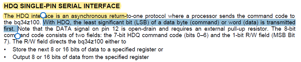

2.After sending, if the host wants to read data of HW_VERSION(0x0003) with I2C, Is the least significant bit (LSB) or MSB of a data byte (command) transmitted
first?
