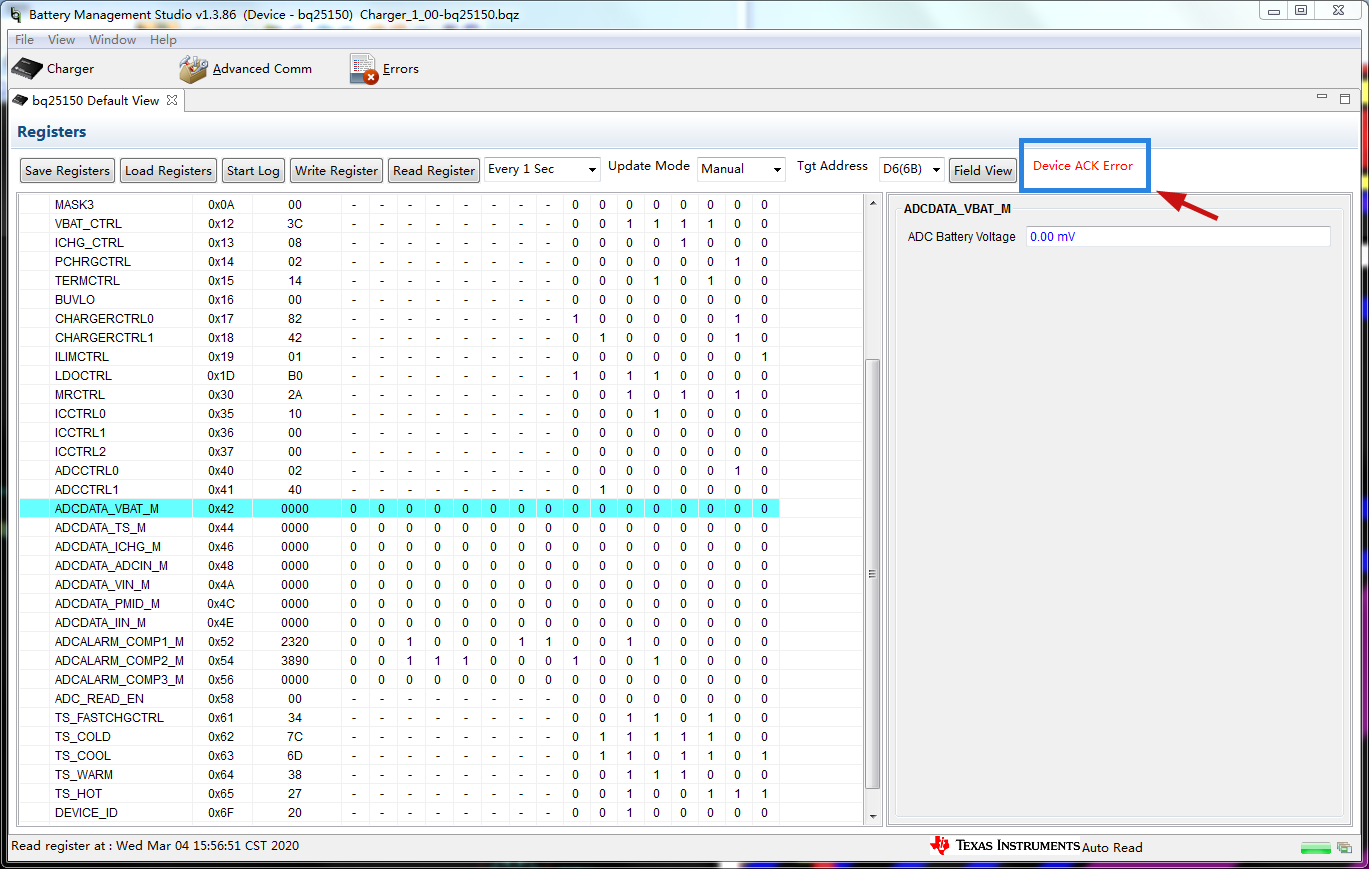

2.VDD, LDO and PMID are not output each time the battery is separately inserted, and I2C cannot communicate.Must insert the USB to restore normal, again unplug the USB is still normal。

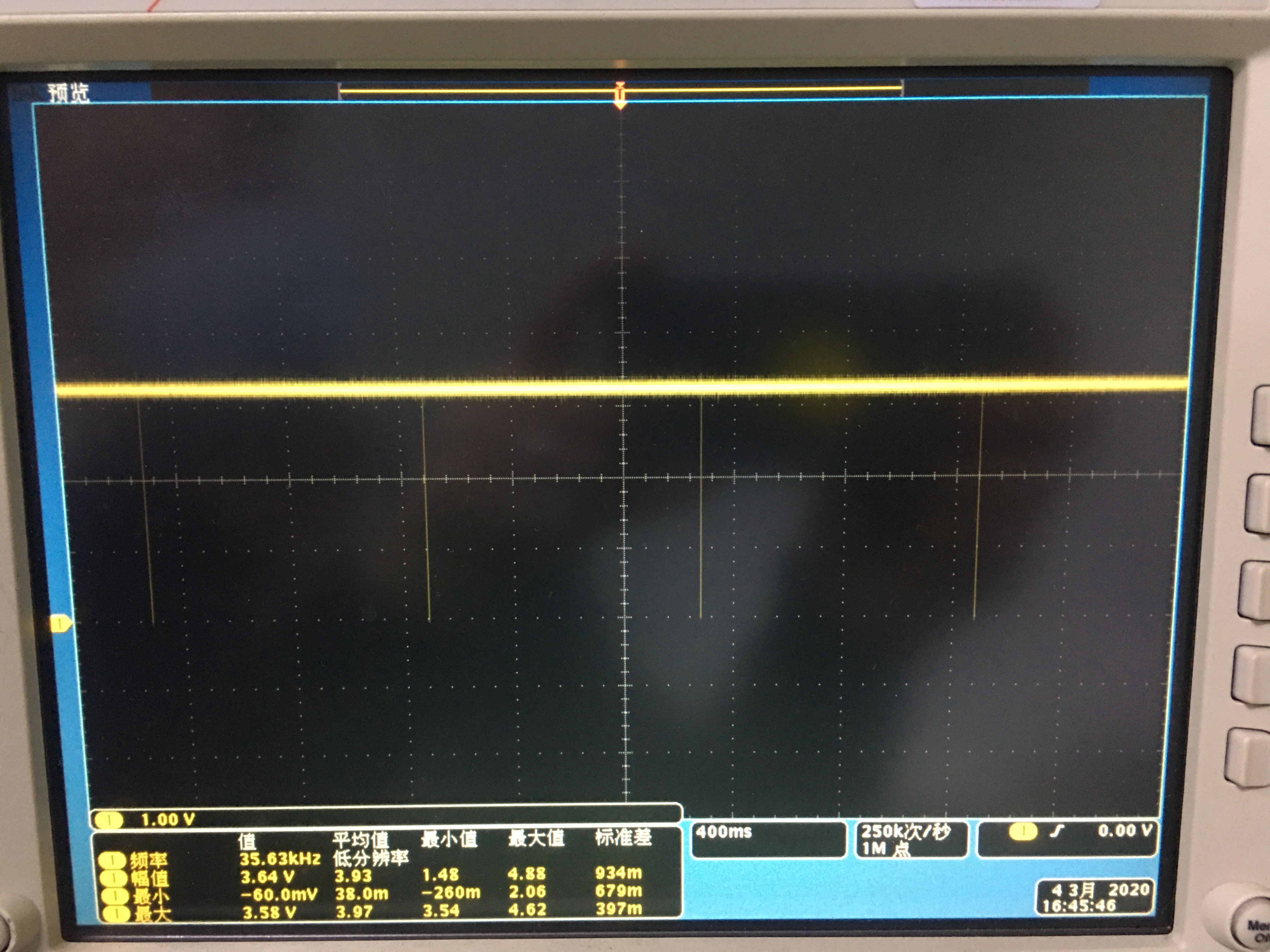

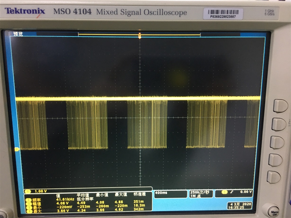

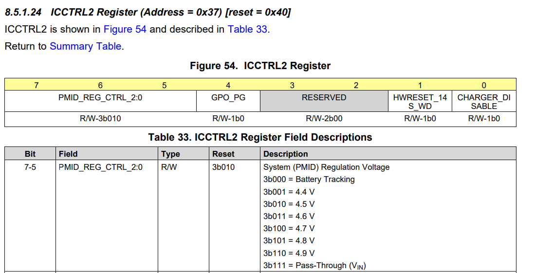

    1.The output capacity of the adapter we used was 5V/ 2.4a, BQ25150 for initial configuration, ILIM=100mA, ICHG=10mA.The PMID output may reach the VBUS value, which would exceed the maximum input of the AMOLED power supply (TPS65631W) behind us.Want to know why PMID outputs high voltage at light load instead of VBAT+ 0.2v?How to avoid PMID output close to VBUS?

    1. On the BQ25150- the VBUS to VPMID is not regulated- if you are looking for regulation, I would recommend the BQ25155 which has the regulation function enabled and you can select the voltage on PMID. On the BQ25150- the VIN to PMID is pretty much functional as a switch with current limit. (attached image of BQ25155 settings)

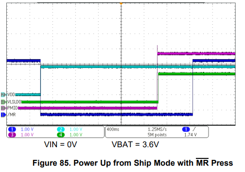

    2. Do you have a scope capture of this behavior- did you hold the /MR low for 2s? VDD will come up as soon as button is pressed and after 2s, the PMID will also come up. The BQ25155 has a wake timer of 125ms compared to 2s on BQ25150. I have included both the samples on this thread for your review.

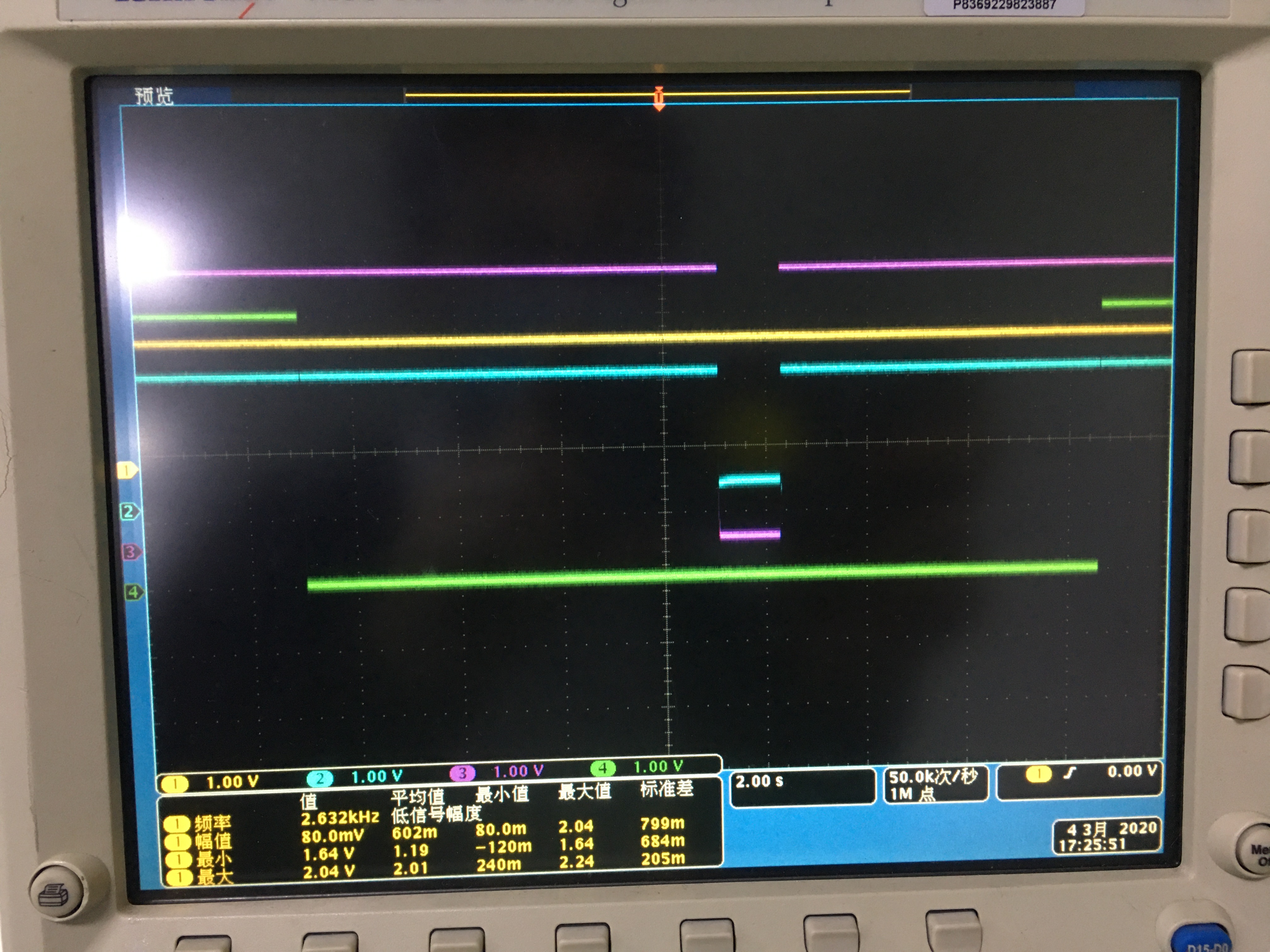

    2.Just try to trigger /MR pin to capture the voltage at each point, the state is correct, please see the following figure:

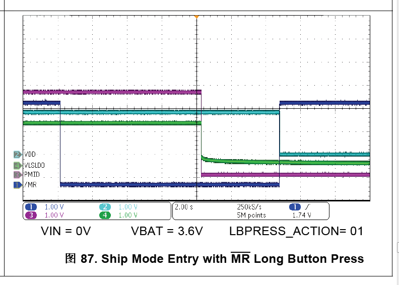

    However, when the /MR pin is triggered again to enter Ship Mode, the capture curve does not conform to the specification, please give the reason.The results are as follows:

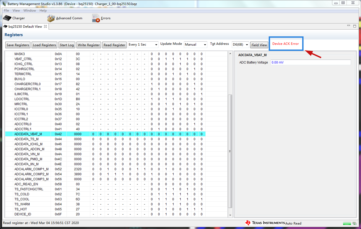

    3.When only the battery is powered, the boot is triggered by /MR pin. At this time, the I2C communication error is caused by the internal use of 3.3v pull-up of EV2400, which is caused by the conflict with the 1.8v VIO of BQ25150?At present, 1.8v MCU has not been used to communicate with BQ25150 for verification.

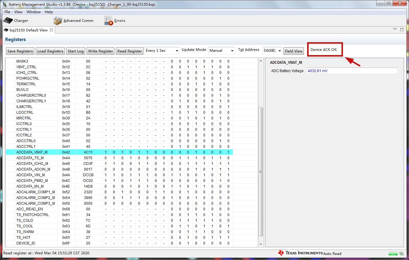

    4. In the third question, after I inserted USB, I2C immediately returned to normal, and bqstudio could read data in real time.Unplug USB instant error, please help to analyze the reason.

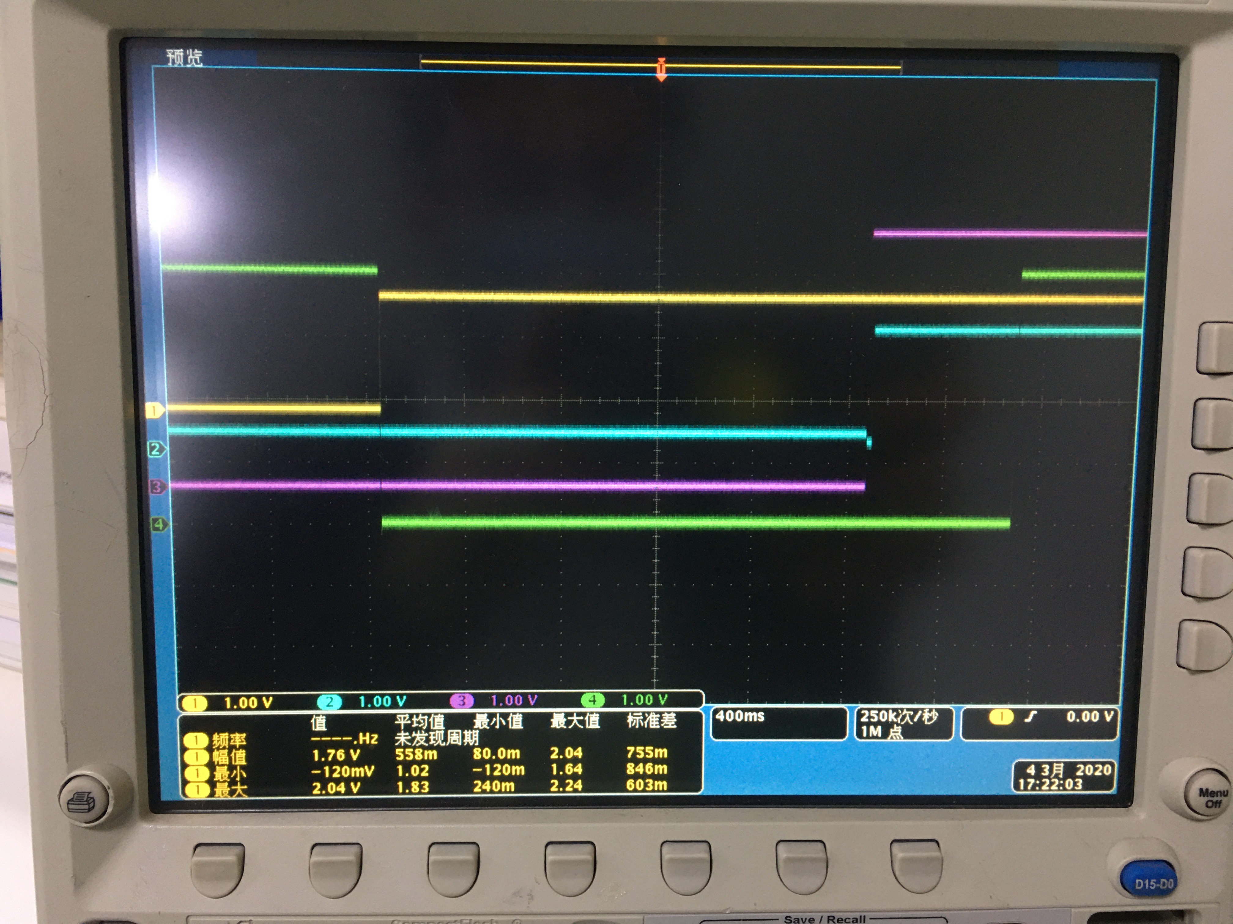

    2. The device on default is configured to trigger a "hardware reset"- based on the scope capture I see that occurring. If you want to go to shipmode on long press, you will need to write Reg: 0x36 (ICCTRL1) with Value: 0x80. Also if you can include markers on which color of trace is which line, that would be very helpful for diagnosis. I think Green is /MR, Pink is PMID, Blue is VDD. Let me know if this is different.
    3. VIO can be 1.8V and SCL/SDA can pull up higher than VIO- not an issue. However, make sure the VPULLUP Jumper is disconnected as the EV2400 has pullups internal to the box. In your system, you will need to pull VIO to the same level the I2C level is pulled up to.
    4. What is the status of the /LP pin? You will need /LP pin to be pulled up high in order to communicate to the device on battery only.

    2.I'm sorry that the second long press /MR waveform I captured is indeed a "hardware reset", and the specification description has been compared.We will consider whether it is necessary to use a long press to enter the ship mode function.At the same time, please forgive me for not marking the line color correspondence.Supplement: yellow is VDD, blue is LDO, pink is PMID, and green is /MR.
    3.By VPULLUP, do you mean the pull-up resistance in my design?Or is it inside the EV2400?Tried to break the system, but could not communicate with EV2400.In addition, we tried to communicate with a 1.8v MCU, which is normal.(note: the inability to communicate with EV2400 is due to separate battery insertion, which only appears after long press 2s /MR to start, but is normal after USB insertion)
    4.I have tried to connect /LP to VBAT, and the phenomenon is the same.

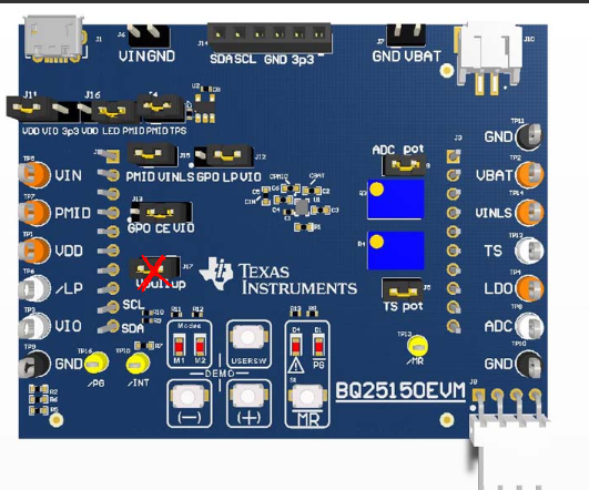

    3. There is a pullup jumper on the EVM(as attached). You can disconnect it if you are using the EV2400. The device seems to be in shipmode this time due to the battery insertion. Long press of 2s on /MR line or one time adapter plugin will wake up the device.

    3&4.The device has been awakened and the PMID voltage output is normal.Just now I tried to drag /LP to VBAT, while opening the internal ADC_READ_EN, which is ready to read through EV2400.So the state of /LP is the key to communication. I think we have found the answer to our question. Thank you for your help.
