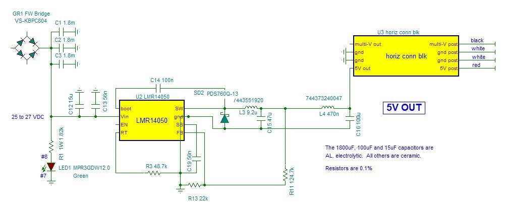

LMR14050-Q1: V out = V in
Part Number: LMR14050-Q1
Other Parts Discussed in Thread: LMR14050
I have a LMR14050 installed in a power supply I am building.  This is designed for 5.0V output.  V_in = 26.79V.  R_fbt = 124.7K and R_fbb = 22K.  I am getting 26.72V at the output and measuring 4.01V, not 0.75V at the FB pin.  Any ideas what might be wrong, or does it seem I zapped the chip somehow?
