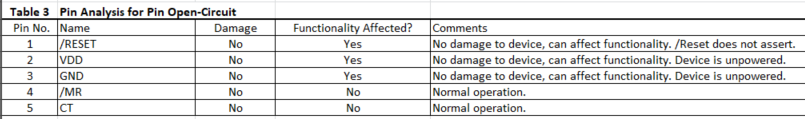

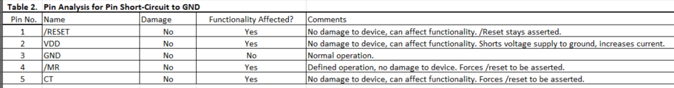

Hi TI-team
Please tell me the behavior of IC when each pin is open and adjacent pins are shorted.
Also, what happens when the CT pin is shorted to GND ?

Could you tell me the result of shorting with the adjacent pin ?
