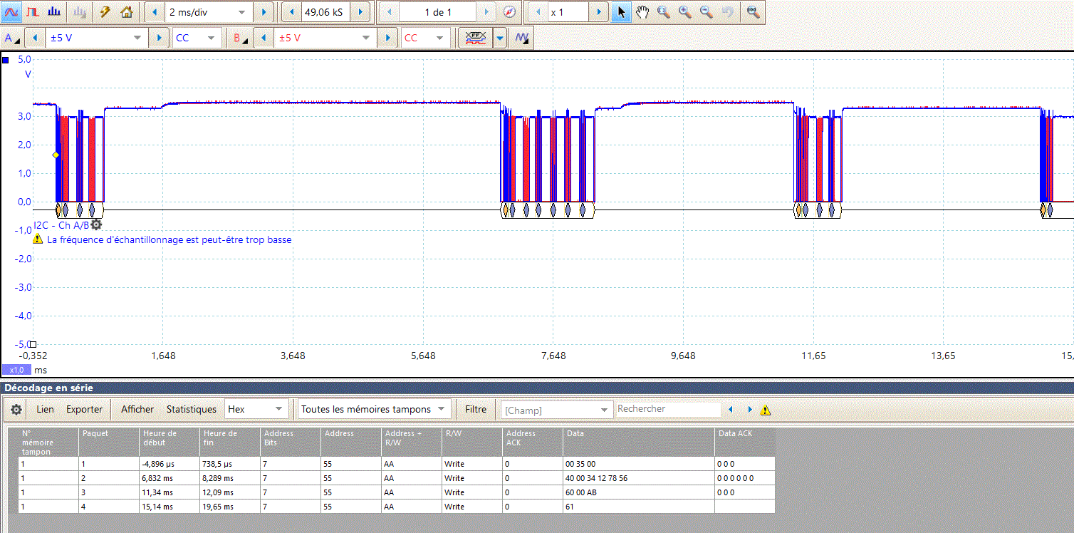

I need some help to use correctly the part number BQ34110. I can easily read the Raw Voltage, Temperature and some other parameters but today i need to unseal the part.
I read the process on the SLUUBF7A datasheet but it seems i don't understand the unseal process.
On the following picture, i try to send the SECURITY_KEYS but i get an error when i try to send the last I2C Frame (MacDataLen - 0x61) and i can't send the Length.
Thank's for your help.
