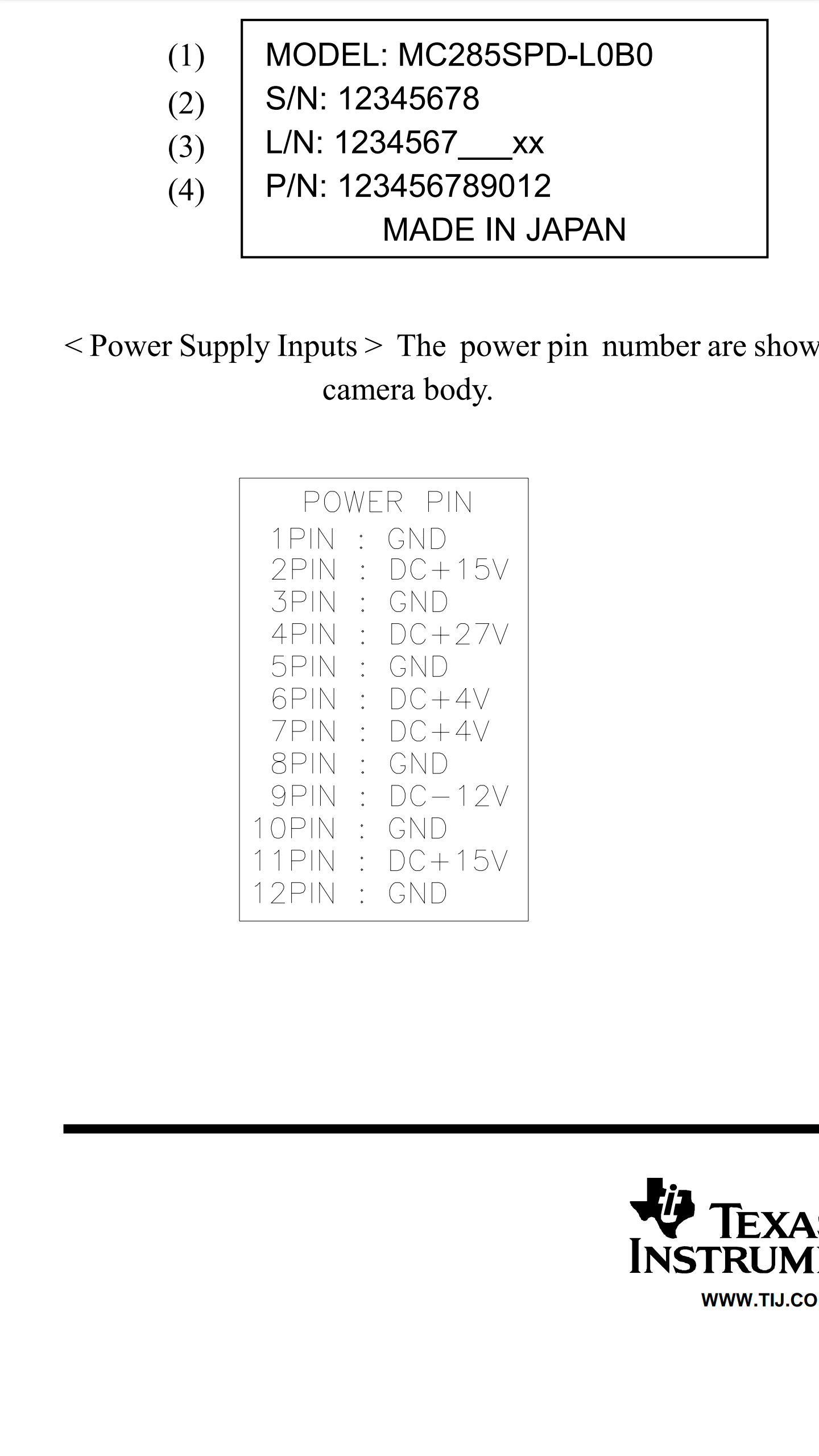

Hi again,
I purchased a MC285SPD-L0B0 em-ccd camera and it didn't come with the power supply. I was expecting the camera to have a pretty straightforward power requirements (ex: 12v PSU). Instead, it look like it requires a bunch of different voltage on a 12 pins connector(see the picture below). Not to sure what to do to safely provide power to the camera.
I also joined the full camera specifications: 2678.MC285SPD-L0B0_Ver1.3.pdf

  • Hello Sebastian,
    To determine sequencing I would have to at least have a schematic of either the camera or the power unit and even then if there are programmable ICs (micro-p, PLD, FPGA etc.) in the design, I would also need source code for those devices.
    I see a name on the power unit drawing in the MC285 specification (T. Hashimoto) and there is a T. Hashimoto at TI Japan so I'll email that person on the off chance that he was assoociated with this design 17 years ago. Not sure on the odds but I'll give it a shot.
  • Thanks you very much for that. However, the more I dig into it the more I'm starting to realize I just bought a rather expensive paper weight. I guess I will have to cross my fingers.

  • Hello Sebastian,
    Perhaps but there's still the possibility of hearing back from Japan. Also, I assume you checked with the original source for the imager and asked about the power supply. At some point, you could just begin experimenting by getting the mating connector with wires and hooking up lab supplies. You might be able to get it to work.
