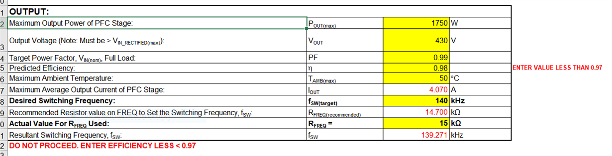

Hi. team.
Why is the UCC28180 calculator limited to less than 97% efficiency?
Hi Hirotsugu:
UCC28180 is single phase CCM controller for bridge boost PFC. The calculator is designed to target boost with input bridge. Mos of the customer's design,the efficiency is less than 97%. So we can a 97% max limited value.
hope this answers you.
