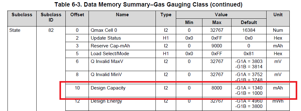

Is there any restriction on this Fuel gauge on the Maximum capacity of rechargeable Li-Ion batteries?
I'll be using Max of 10000mAh Battery.
Thanks.
Thanks.
Could you please attach the link of the pdf file where Data Memory summary is defined?.
I do not see this information in the data sheet.
Thank you
I'm glad you found this information. This is not a DS EC table spec.
