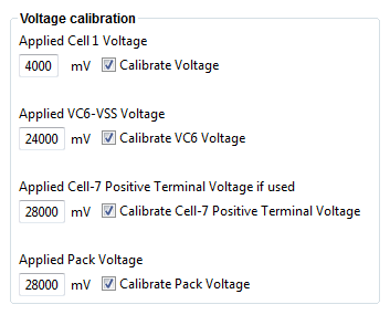

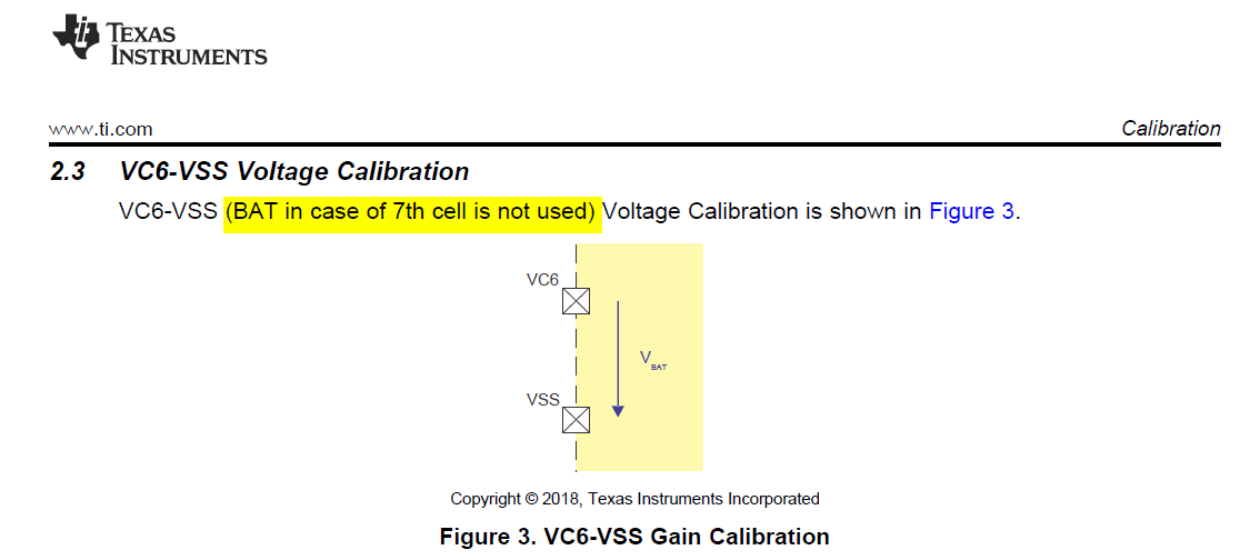

Hi everyone.
I have a problem with cell calibration by battery management studio 1.3.86.
I set each of 7 cells to 4V on resistors voltage divider. I eter the values for calibration (see attached picture). But I always get 7th cell near 3940mV ad not near 4000mV.
All other cells are near 4000mV.
Only if I manually adjust VC7 Sense Gain I achieve desired 4000mV at 7th cell.
Does anyone had the same problem with calibration by battery management studio 1.3.86.???
Is there any solution to this?
I attache 2 gg files with manual and battery studio calibration.
