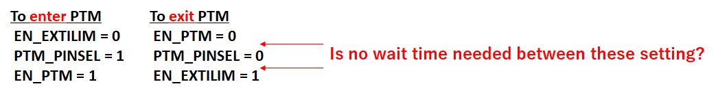

Please let me know if the wait time is needed between setting each bit at procedure of enter and exit PTM. Please refer following.
Satoshi
Hey Satoshi,
I don't believe there is a wait time required between these events.
You are only limited by the register write time.
