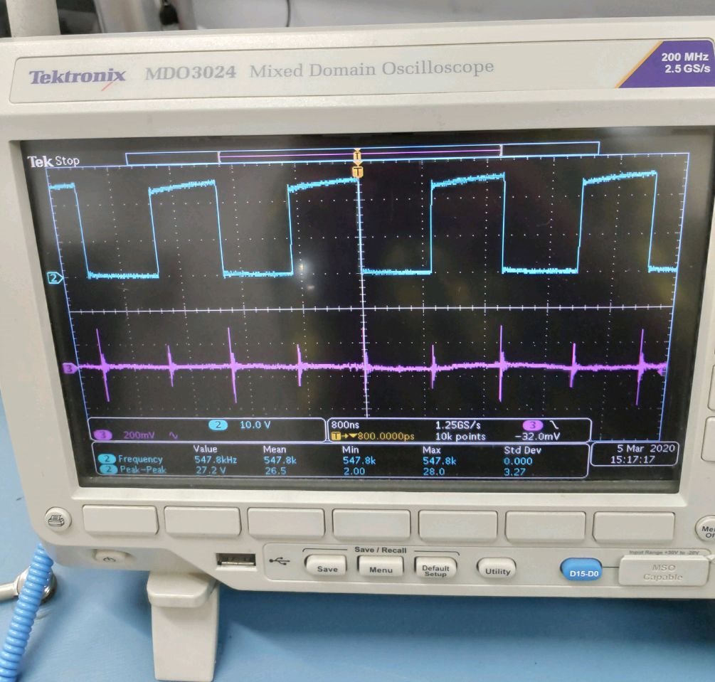

We are using LM3481 SEPIC converter with input voltage 9-36V and output voltage 12V @ 1.5A.
We are using this 12V only for LCD Backlight supply. Whenever we connect LCD, we are getting ripples of around 450mVpp @ switching frequency. Attached is the snapshot of waveform of ripples on the output rail in sync with its switching frequency and snapshot of schematic.
CH 2 - LM3481 switching waveform
CH3 - Output ripples.
Please suggest solution to reduce these ripples.
We have tried following solutions:
- Replaced C332 with 33pF and 100pF.
- Placed one more 47uF cap.
  • Hi Sahil,
    Thanks for using LM3481.
    To me, your output switching ripple is OK (<40mV). Are you worried about those spikes?
    Those should be just the switching noise. Try probing the output voltage directly at the two terminals of the output cap using a short probe like tip and barrel.
    Please let me know if you have further questions.
    Yinsong
