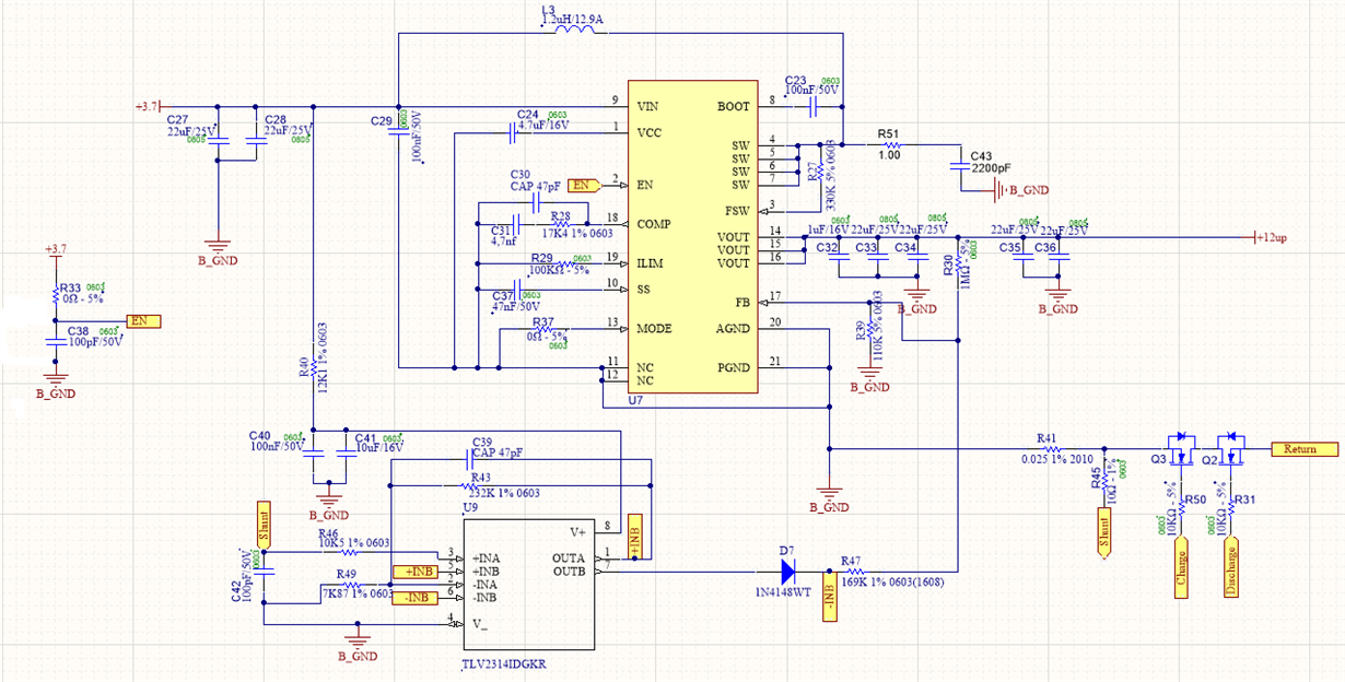

Hello everyone!

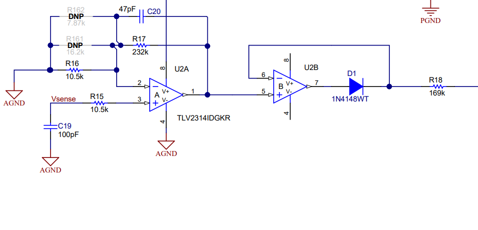

I am using the TPS61088 in an application, which converts the 18650 lithium battery voltage (2.8V to 4.1V), to a higher voltage 12V / 1.5A. To protect the output of the converter I am relying on the PMP9806, which as I understand it, limits the output current protecting the circuit. How do I modify the operational amplifier circuit values ​​(RADJ "R18", R17, R16, R15 and C20), to act as a 12V / 1.575A protection?.
Another question I have, and what are the labels V1, V2 and V3 in the schematic ?.
Circuit shown in the PMP9806 limits the voltage too?.
