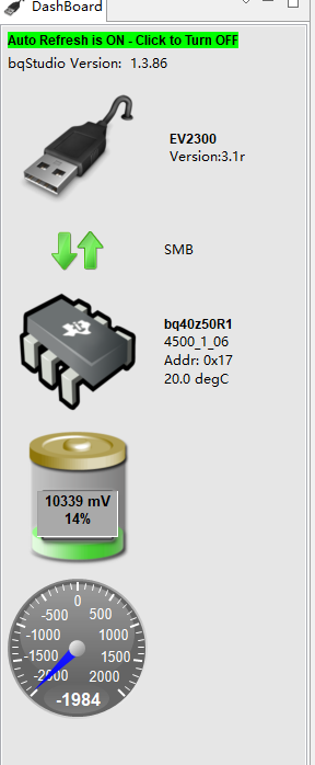

We have completed the calibration of BQ40Z50 using the HPA495A+EV2300+BQPRODUCTION and have two questions after the calibration.

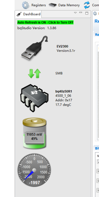

Firstly, We have calibrated the current using HPA495 and DUT and got the correct value already like this:
Then we have operation are as follows:
  1. Read Srec from device;
  2. Program another new DUT;
  3. Use electronic load as load;
  4. Discharge at -2000mA;
  5. I got incorrect current value:-1984mA.
So,Why is the current inaccurate when we use an electronic load to discharge?
Could the calibrated value be applied to other scenarios with different loads?

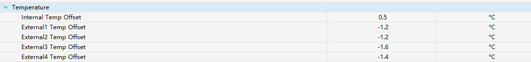

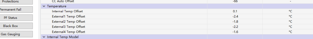

Secondly, We used the HPA495A+EV2300+BQPRODUCTION to calibrate two DUTs and then I checked the data Memory from two DUTs with bqStudio.
DUT1:
DUT2
Different DUTs got different values.
 So,How can I use only one "**.srec" file for mass production?
  • Hello Sheldon,
    This is within reason. Did you calibrate the sense resistor? Please use the calibration plug-in in bqStudio, calibrate the srec file over the boards, average out the CC Gain/Delta values and recreate golden image.

  • Hello Sheldon,
    I would use bqStudio for a single DUT. For multiple DUTs, thats bqProduction.
    You could try averaging across 30, this is just a suggestion. Try to calibrate so that it reports 2000 mA when you apply 2000 mA.
  • It could also be that your sense resistor values are drifting. Please measure voltage drop across sense resistor and make sure the temp co is not changing the resistor value by too much.
