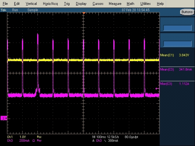

Q13.  Can RASH current load (peak1.2A length 10msec) be average current and coulomb count accurately?
(Load Current sample.jpg)

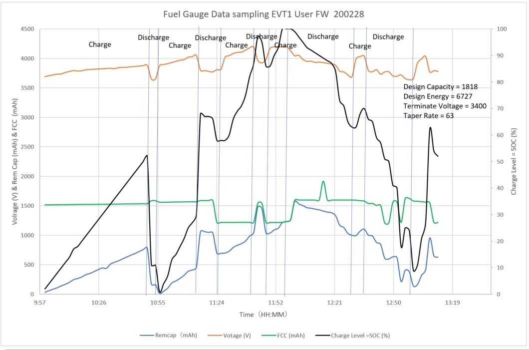

Q17   As shown in this SOC_graph, if you discharge while charging and then charge while discharging after setting the data memory,
         the SOC will probably fluctuate rapidly due to voltage fluctuations. Is this because the data memory cannot be set properly and correctly?  (SOC_graph.jpg)

    Q13: It depends, please do a test on the EVM and measure the gauge measured coulomb count in Passed Charge register and compare to machine integrated.

    Q17: The gauge state machine will try to compensate, but you should really have relaxation regions during the typical use case for impedance track. Otherwise, our OCV readings will become less accurate over time.
