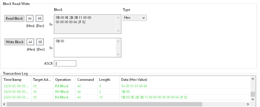

I'm using bq78350 with bq76940 for one of my project
I want to fetch afe config data from bq78350-R1 using 0x59 command.
I'm using Bqstudio and ev2400 to communicate to bq78350.
In response to my read command, I'm getting some random data but not the actual data of afe registers
What is the correct procedure to read afe data registers ?
