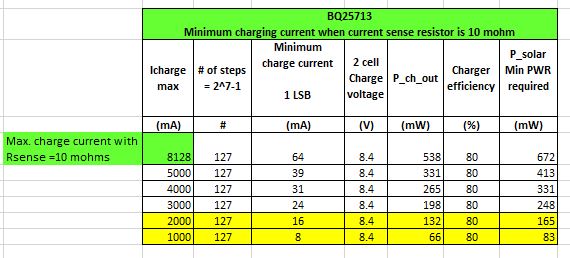

  • Hi Joel,
    Thank you for details.
    From  BQ25713 datasheet, Table 4. Charger Command Summary (page 33,), with the assumption that sense resistor is 10 mohms,
    it can be seen that there is 7-bit ChargeCurrent() register, to setup charge current.
    I created a spreadsheet to calculate minimum charge current = 1 LSB, where I varied maximum charge current.
    Looks like the maximum charge current needs to be reduced down to about 1 or 2 amps, in order to be able to use low available power from the solar panel.
    In that case, sense resistor value needs to be increased.
    That would allow using cheaper low power solar panels 2W,  or 5W.
     To have both options, high and low charging current, the current sense circuit gets a little bit more complex.
    That can be achieved by a combination of one sense resistor in parallel with the other resistor plus PFET transistor. Rs1 || (Rs2+PFET)
    PFET would be turned on when high charging current. That is in the case when a wall adapter is connected.

  • Hey Spring2020,
    When it comes to charging current, it would be more advantageous to consider the LSB as a differential voltage rather than a current.
    And instead, the current that flows would be function of the differential voltage / Rsense.
    In this scenario, the LSB is actually 0.64mV (640uV) across all cases.
    To be quite honest with you, I don't believe your MCU has to do that much work. The charger has integrated loops to account for a solar-type input, namely the VINDPM loop. Under VINDPM, the programmed charging current does not matter because the charger under VINDPM will automatically reduce the charge current anyway.
    The other challenge to solve for you are two different input source types, which I would implement with a power mux, like the TPS2121. With this device, you can program the first channel as the priority being the USB adapter, and the second power source is the solar panel.
